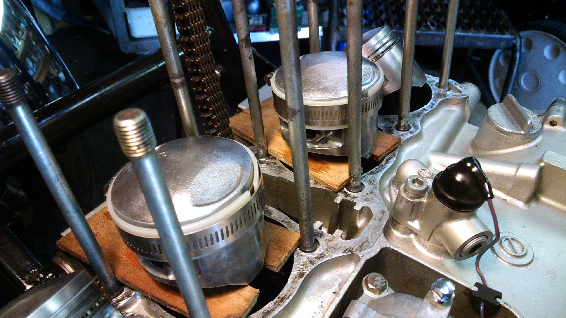

Re: Wet Piston Crowns?
13 Sep 2018 10:36
#790821
Thanks guys! I'm betting it's the valve seals. Gonna remove all valves and install another new set using the plastic tubs. Didn't notice them before, but they must come with new valve seal kit? Pic attached showing wet Cyl # and #2.

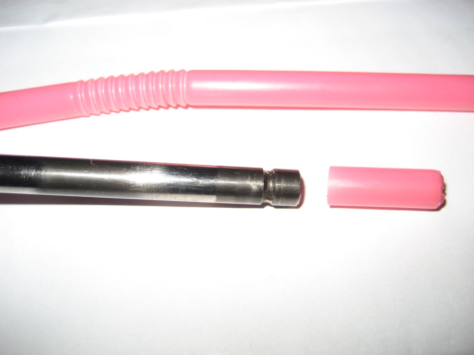

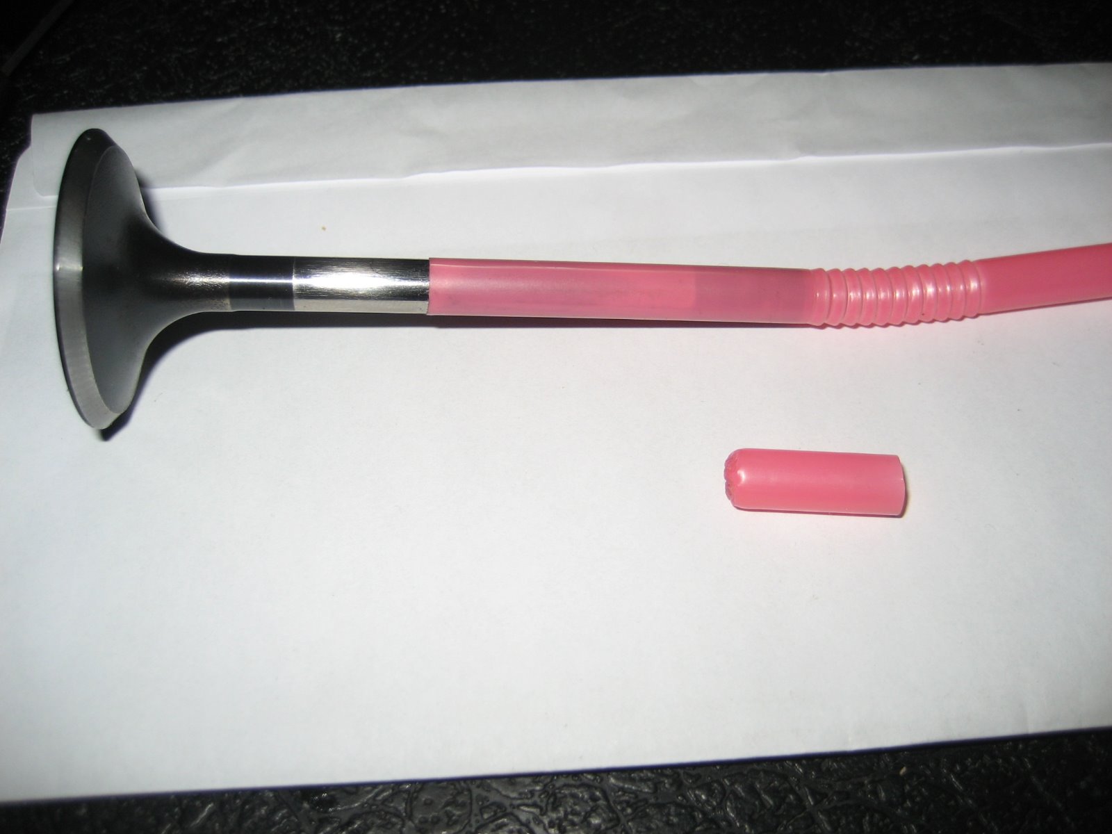

13 Sep 2018 11:44
#790823

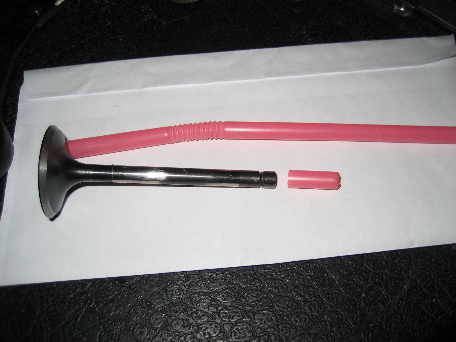

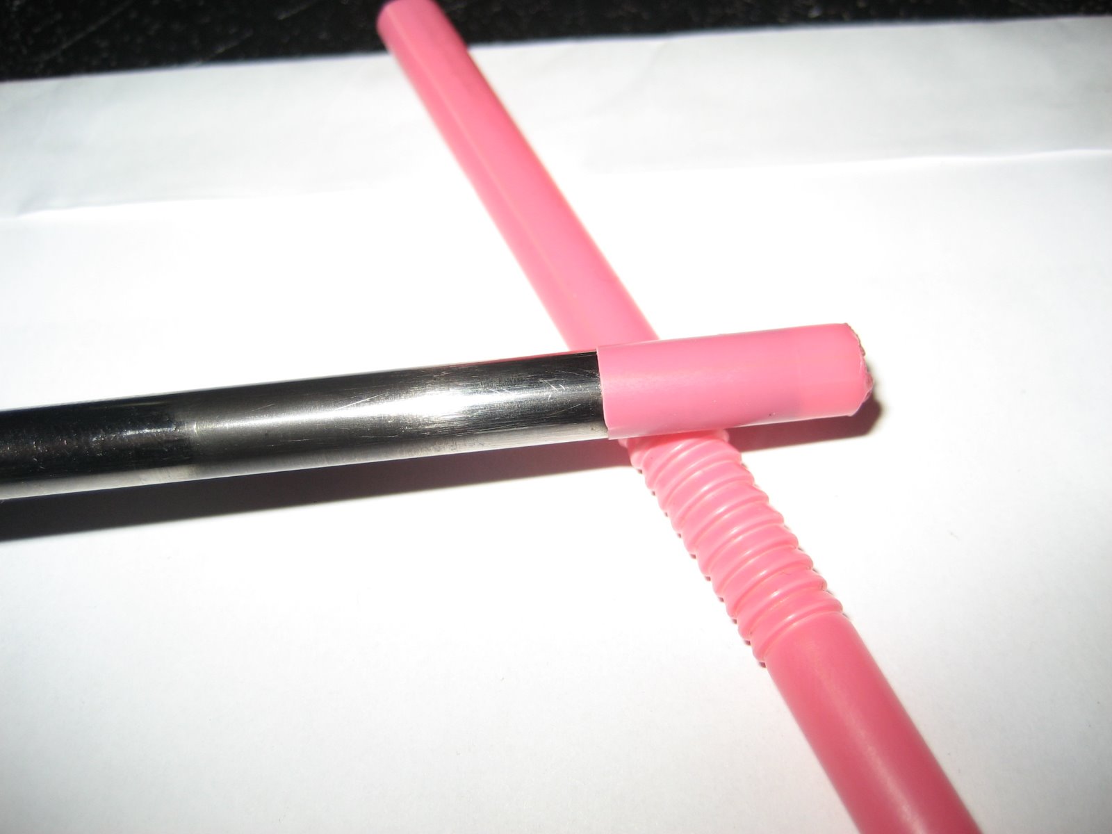

If no plastic tubes are in the valve stem seal kit made your own from a drinking straw.
Forming the top of the tube with some heat gun.

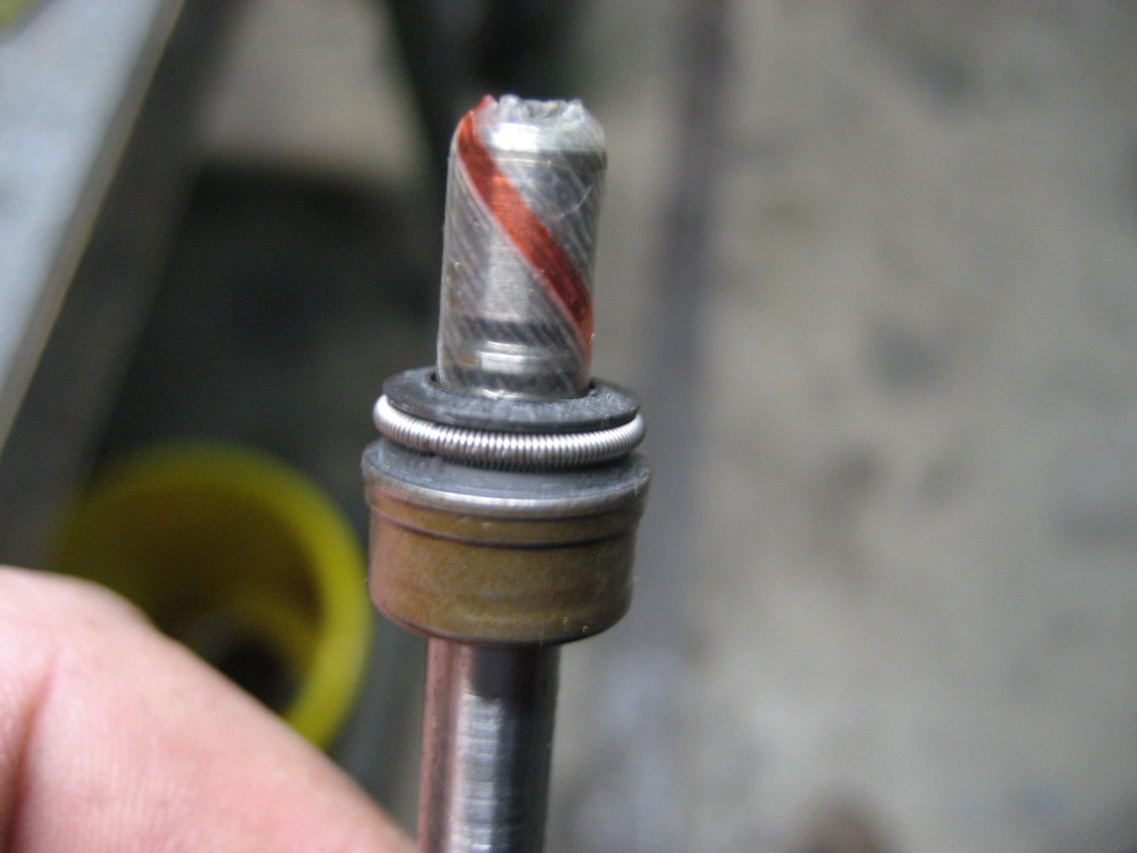

  • old_kaw
  • old_kaw's Avatar
  • Posts: 929
  • Thanks: 270
14 Sep 2018 08:59 - 14 Sep 2018 09:04
#790857
KZ1000P1995 wrote: Thanks guys! I'm betting it's the valve seals. Gonna remove all valves and install another new set using the plastic tubs. Didn't notice them before, but they must come with new valve seal kit? Pic attached showing wet Cyl # and #2.
WOW, in looking at this pic, those pistons are soaking wet! Was blue smoke coming out of the exhaust, or is that gas?
Bad valve seals will normally smoke upon startup, then clear up as the oil gets burnt off. (oil runs down the guide when the engine is off) With rings, it will smoke all of the time. Pick your poison. :-)
As texaskz pointed out, it is extremely easy to overlap the oil expander ring, having done it myself. these motors are really tricky in some aspects as of assembly (rings and cam timing) and that expander ring pretty much overlaps it's self when putting the block on. I had to give up my makeshift ring compressor and carefully work the rings into the bores with my fingernails while double and triple checking their progress with a flashlight. The taper takes over once everything is properly started, and centered in the bore.
I managed to overlap the oil expander on one hole using this method.
hope this helps.
14 Sep 2018 16:55
#790878
Maybe you get foolen by the picture, but the cylinder wall is not looking good on the photo???
Project:
  • old_kaw
  • old_kaw's Avatar
  • Posts: 929
  • Thanks: 270
14 Sep 2018 22:40
#790888
gordone wrote: Maybe you get foolen by the picture, but the cylinder wall is not looking good on the photo???
You are correct Gordone. I did not even notice that #2 hole., just the dripping wet piston domes. WTF is up with that cylinder wall? IS that #2 bore wasted, or is that just oil dripping off of the cylinder walls?
1981 Kawasaki Kz1000K1
  • TexasKZ
  • TexasKZ's Avatar
  • Platinum Member
  • Platinum Member
  • Posts: 8404
  • Thanks: 2789
15 Sep 2018 05:58
#790900
Top of that piston looks weird, too. Hopefully what we are seeing is some strange reflection.
  • SWest
  • SWest's Avatar
  • 10 22 2014
  • Posts: 23779
  • Thanks: 3045
15 Sep 2018 06:08
#790902
Like to see better pic of #2.
  • KZ1000P1995
  • KZ1000P1995's Avatar Topic Author
  • Posts: 36
  • Thanks: 2
15 Sep 2018 10:55
#790916

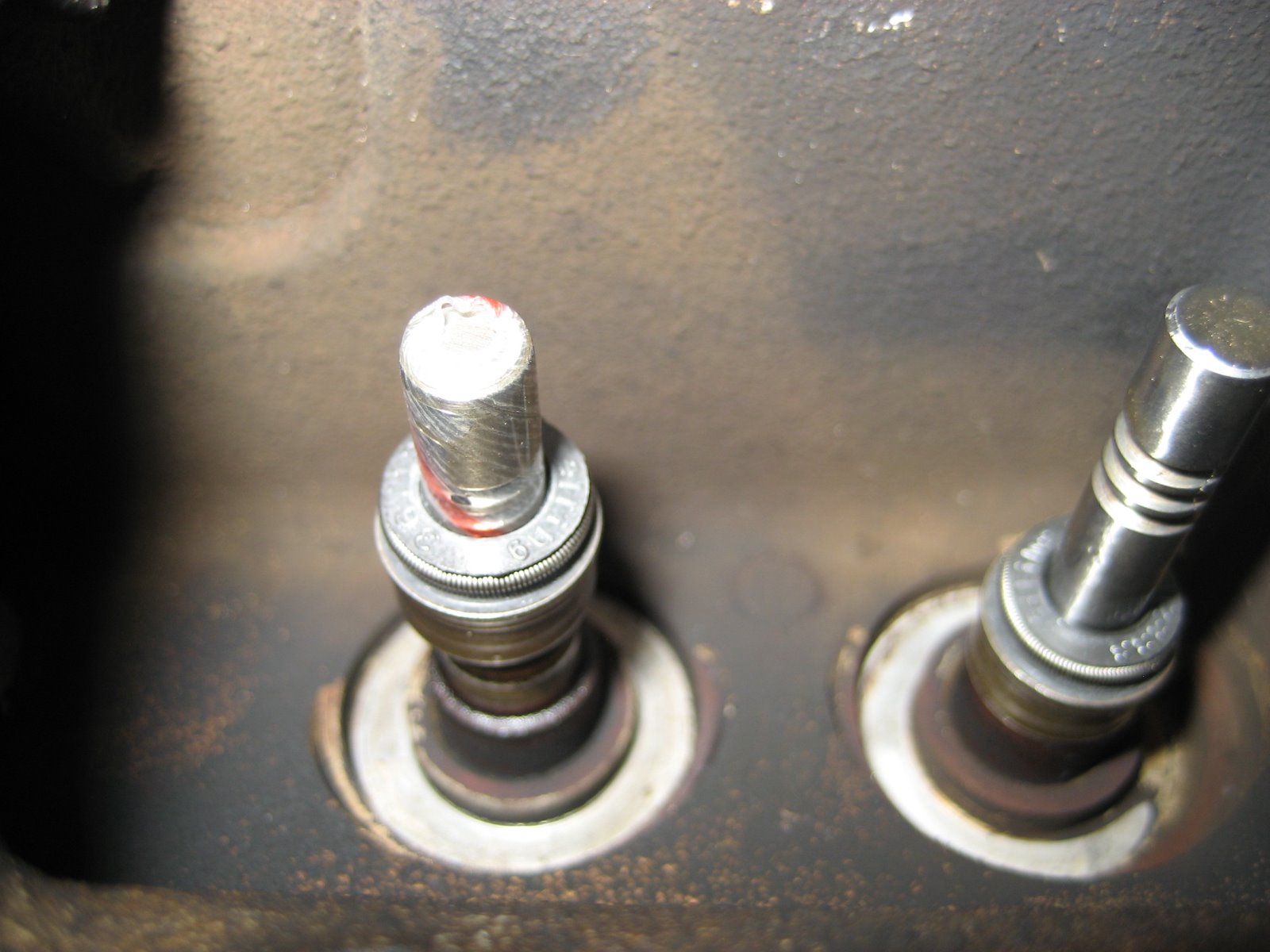

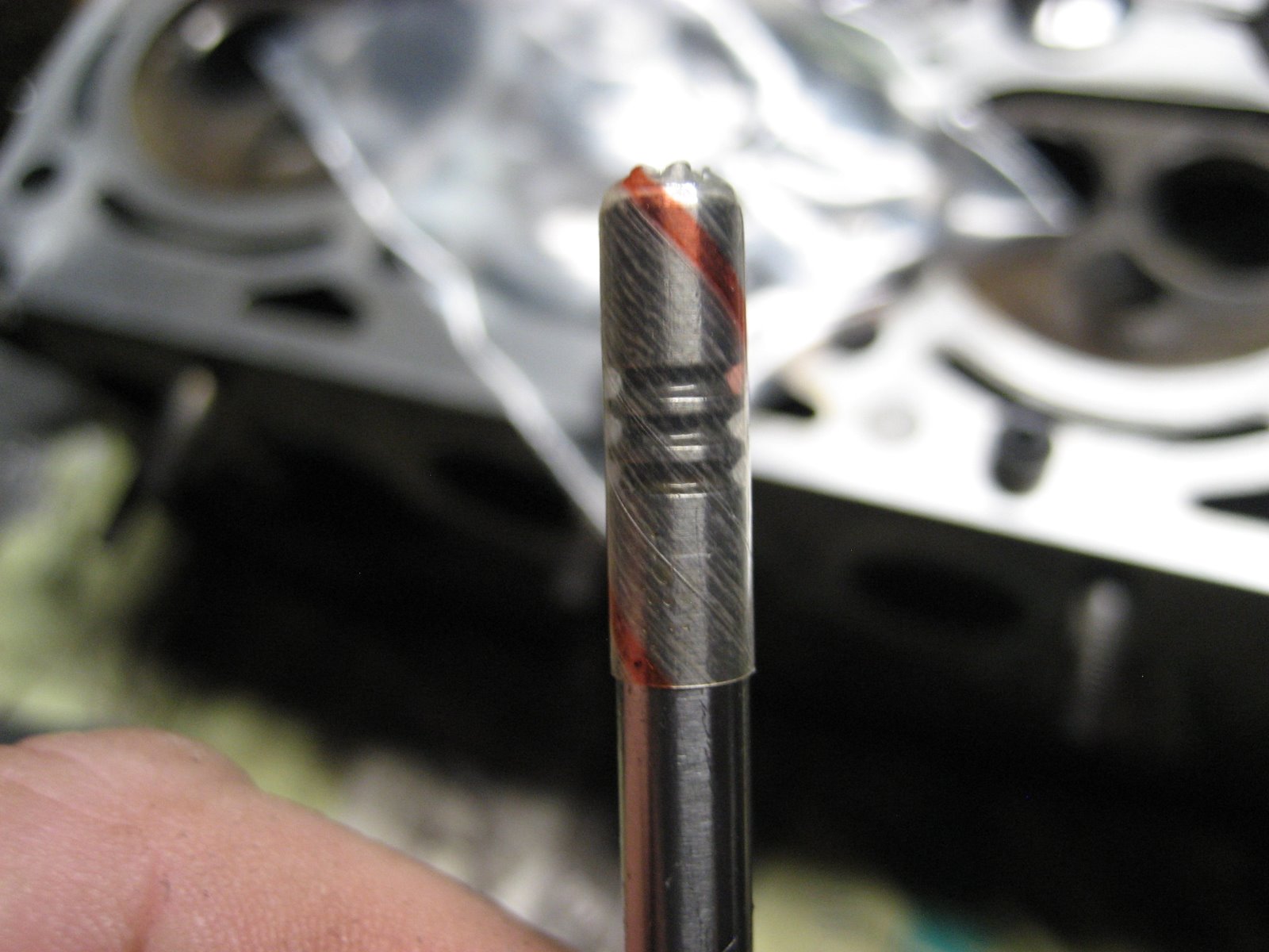

Hey Fellas,
Okay, so I looked closely at #2 cylinder with a flashlight and it looks GREAT. I had it honed by a shop and installed new rings 800 miles ago. Still beautiful cross-hatch with no other markings. VERY dark and wet combustion ring at the top of Cyl #2 though. Hard to imagine that Cyl #1 and especially #2 ever fired! I definitely checked exhaust pipes on warm up regularly and they all heated somewhat uniformly.
If memory serves, it would smoke on startup but then run smoke-less after warmed up. So, two possible mistakes: I have repeatedly installed and removed the valves without a plastic condom (haha) AND I could have easily overlapped the oil expander rings, as I installed the cylinders by hand and remember being concerned about the rings. Hesitant to remove the cylinders, as I already have a new head gasket but can't find a new cylinder gasket without buying the whole top-end gasket kit.
Questions: Are the valve seals definitely ruined by installing the valves multiple times without a condom? Should I remove the cylinders to check the oil control rings? Thanks guys!
