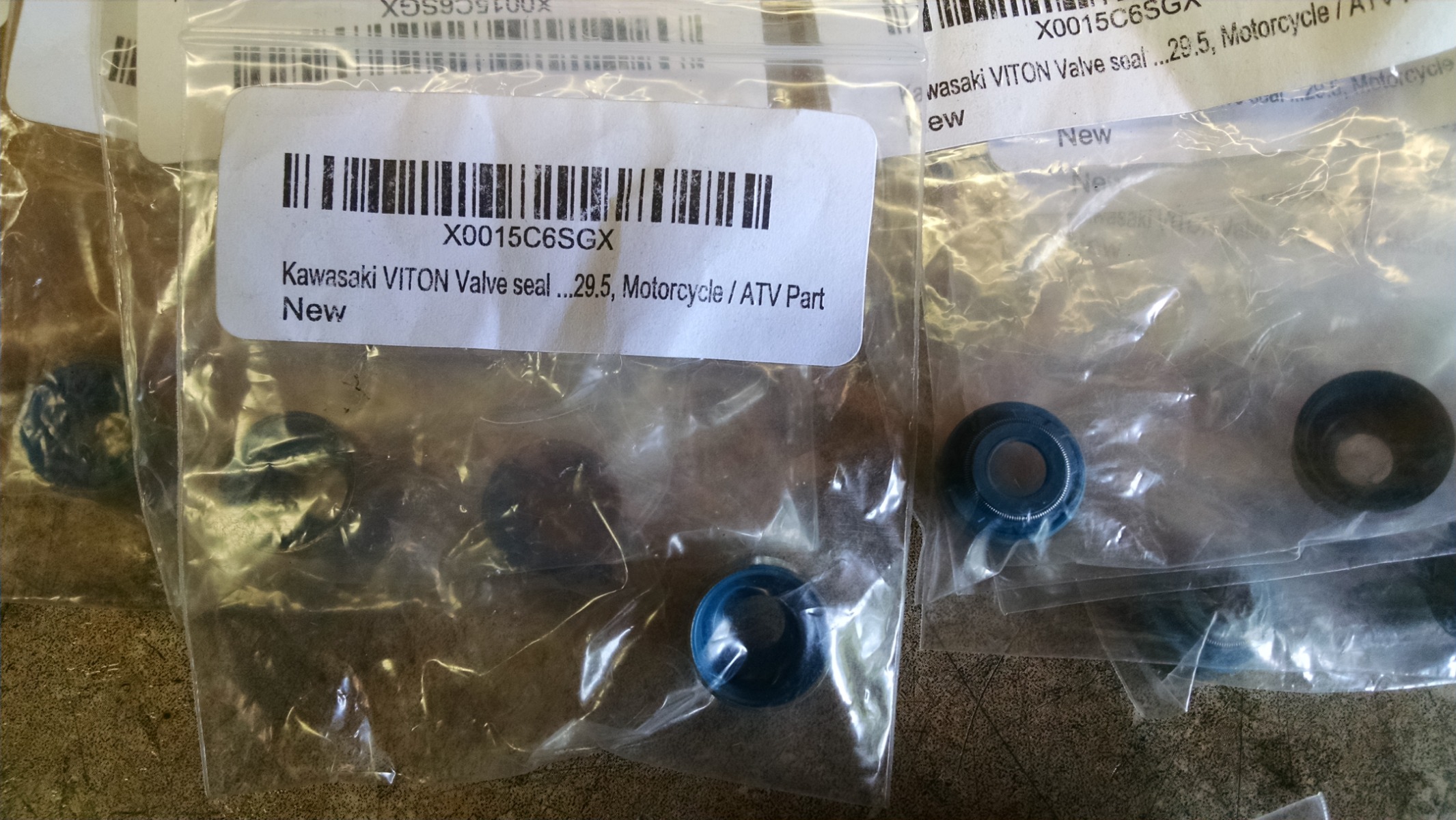

Re: Wet Piston Crowns?
15 Sep 2018 12:55
Never knew they could be damaged by the valve stem. Seals are only 800 miles old!
15 Sep 2018 13:21
May have come loose.
- KZ1000P1995
- Posts: 36
- Thanks: 2
15 Sep 2018 13:57
Looking at them right now. They look undamaged and springs are still in place. Can feel good resistance when I push the valve stem through.

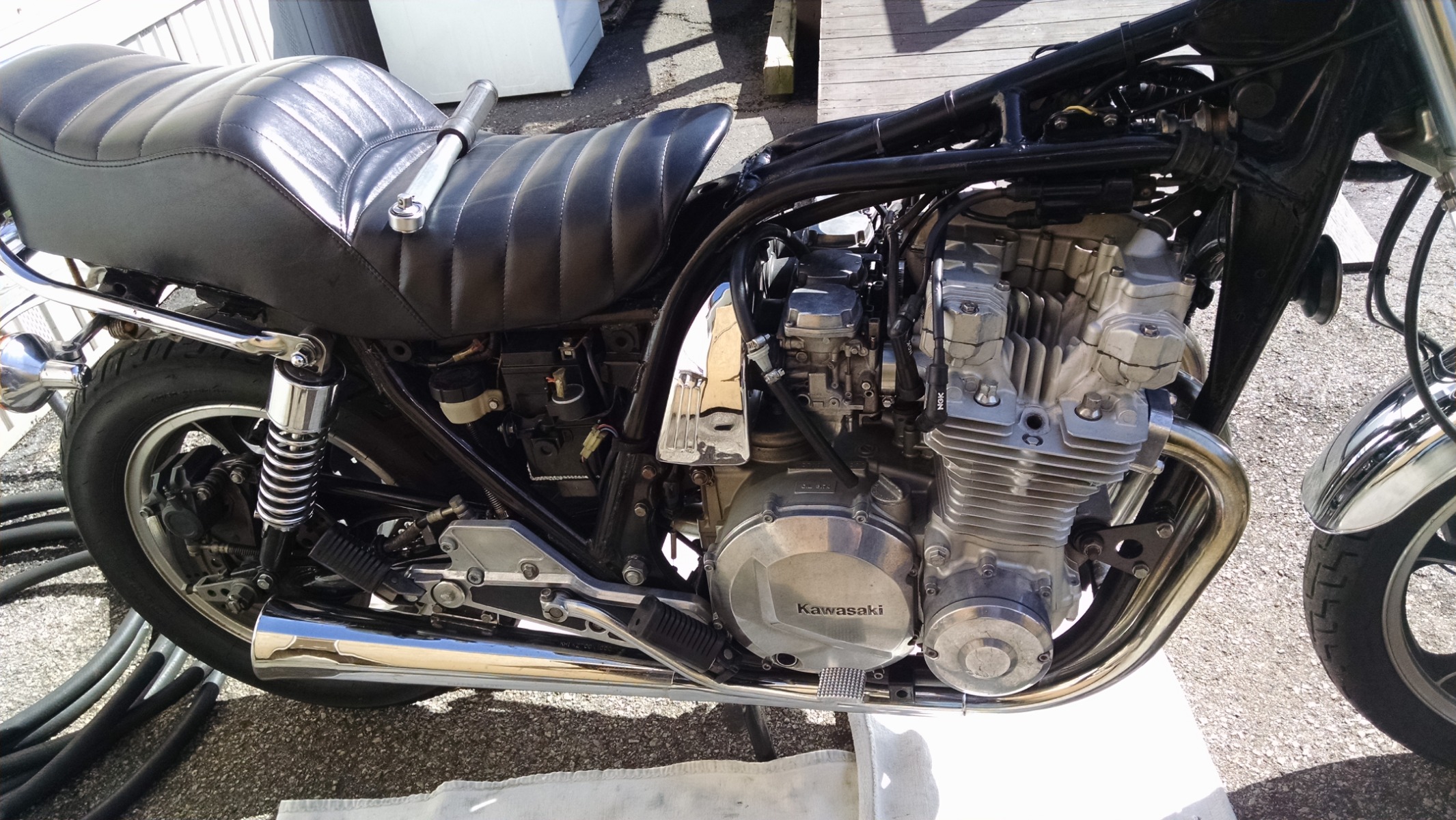

15 Sep 2018 16:38
Hmm, just pulled the cylinders and everything looks good, dang it. This is Cyl #2 up close. Kinda hoping for an obvious problem. Sure is dirty around the studs, wth?
