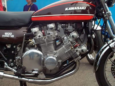

If you want to build a head turning motor to prove your talents as a fabricator why not just
do something like this ????
