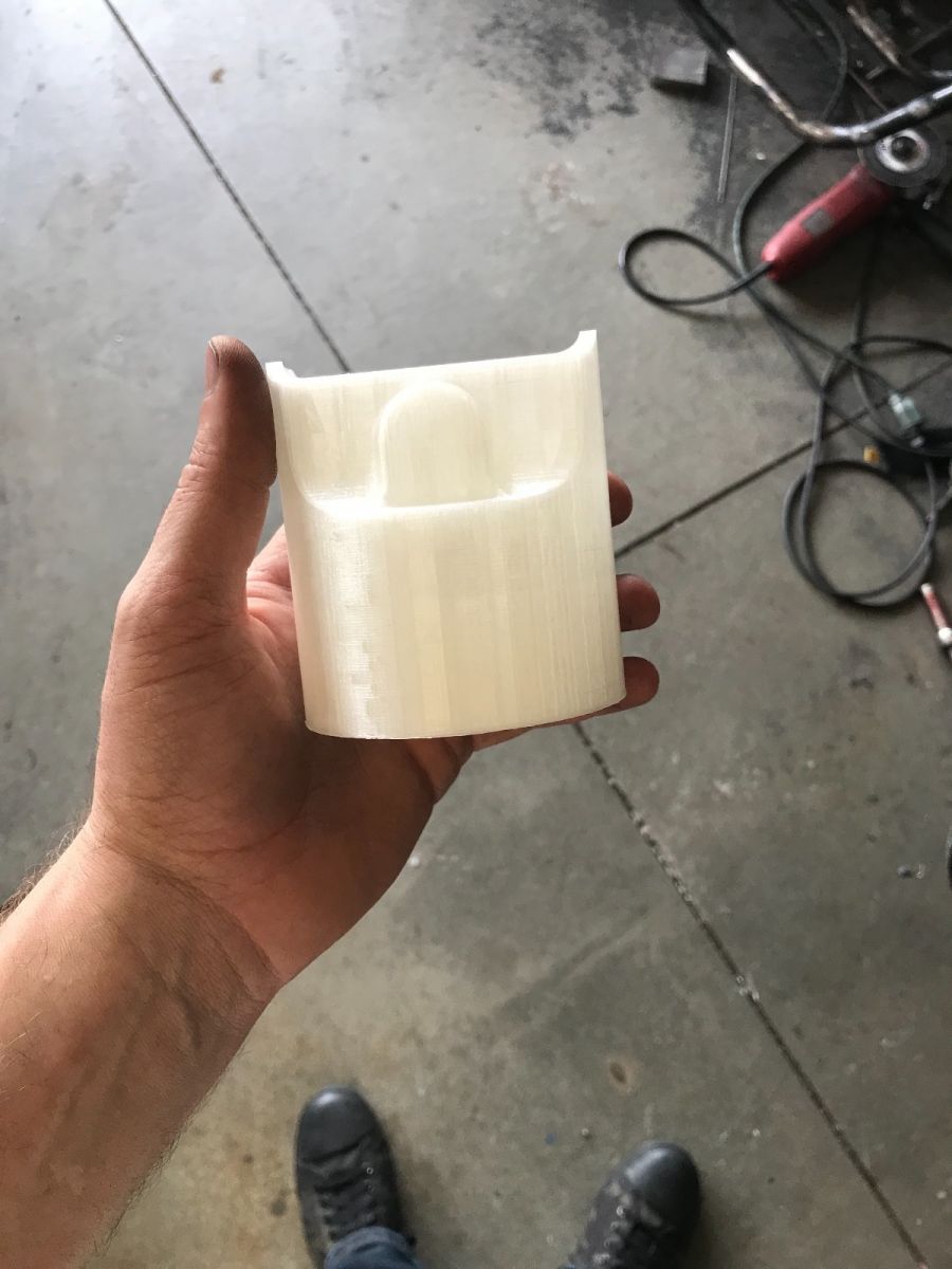

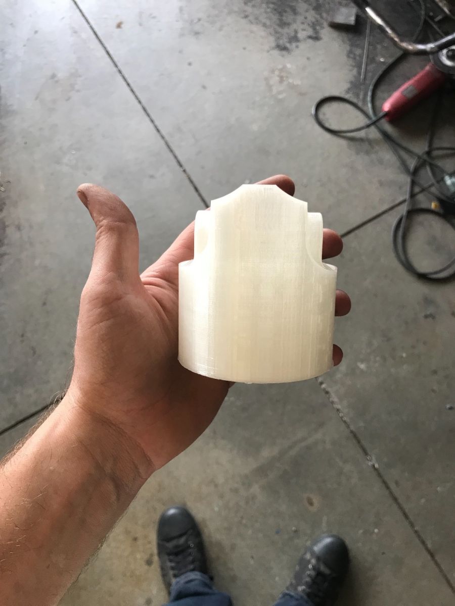

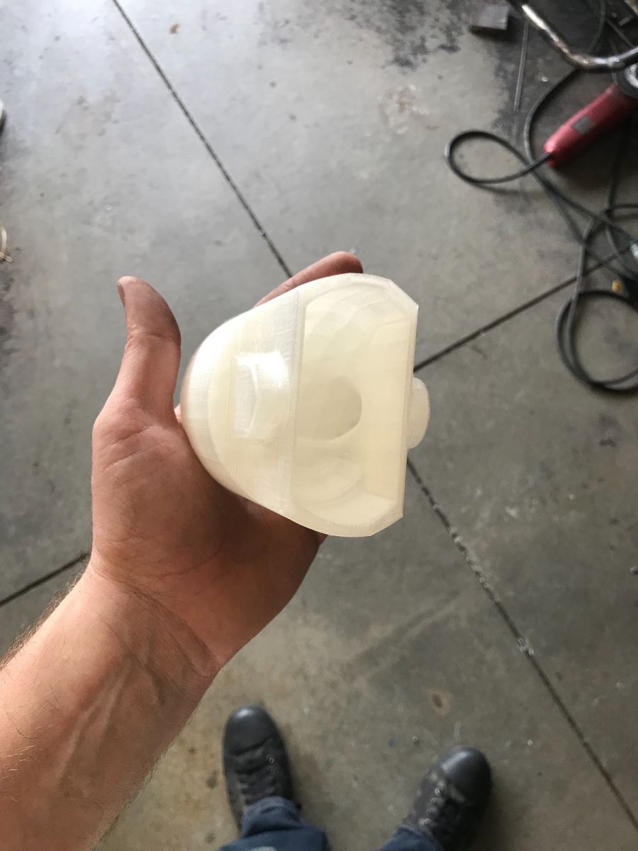

Well my 3d printer only made one piston, missed the note that I needed 4 pieces. But the first came out fantastic! Can’t wait to get the rest back so I can get to casting! Also got some parts back for my next psychotic idea! Take a look!

Please tell me you're gonna finish this. I would love to see a video of this running.
