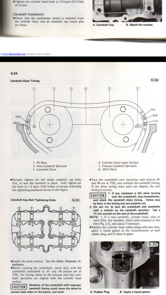

If it was fine before you did the vaive gaps and now isn't are you sure your valve timing is correct? Did you take the cams out to change a shim or two? and possibly not put the cams back timed correctly?

I will try a timing light. And my timing should be correct. Both the timing marks are flush with the case and the IN mark is between the 45th and 46th chain link rivets back from the front marking. Its weird it ran fine after I cleaned the jets then got about a block down the road and it died again. I will throw more gas in as I am pretty low and maybe get a new fuel filter. It's got to be something stupid lol

Hope that was a memory trick, you don't mean 45/46 I hope?

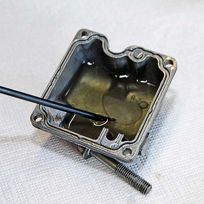

You mean fuel in the oil, do a sniff test.
Carb overflow into the engine oil!!!

No lol my gas has bubbles of clear liquid in it it was in my carbs and then I just noticed it in my fuel filter I'm thinking it's water from when it rained and hasn't worked through I barely had any gas so I topped it off and when I get to 2k rpms from idle it dies. I may pull carbs off again and clean them one more time see what it does. Noticed my petcock is leaking a little as well so may check out the diaphram

Yes exactly that! How do I fix this?
