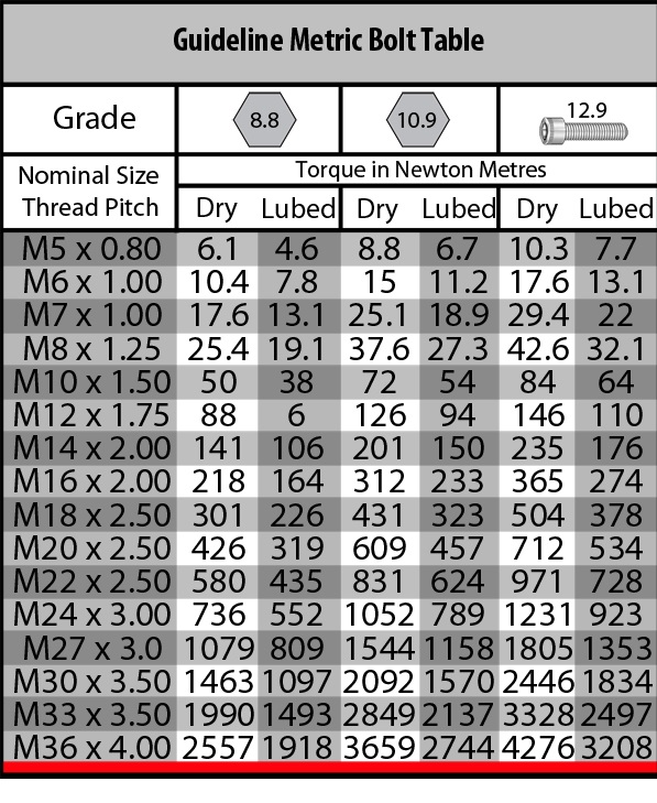

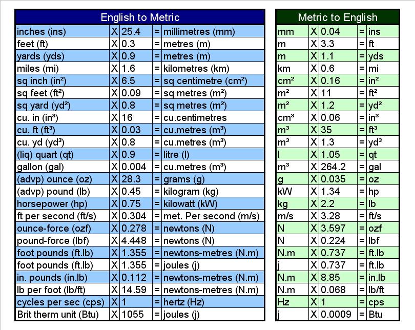

Here are some conversion and torque charts.
On M5/M6/M8 threads i go the safe way and use the lowest value of torque.
Never had a problem with it.
