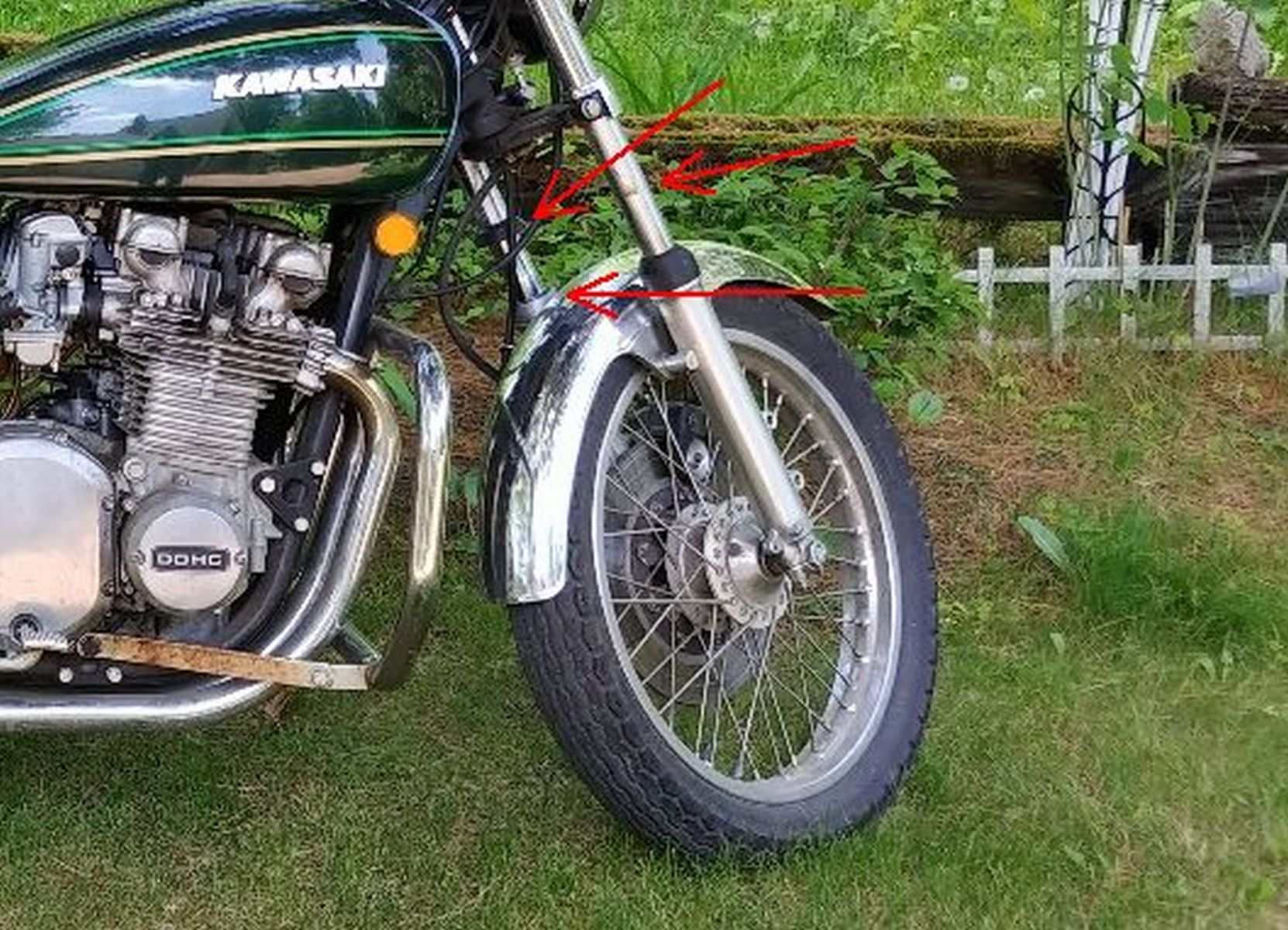

You have to renew your fork oil, seals and dust caps.
How old are your tires? Be careful when driving with old parts = unpleasant surprises.

Yeah, that's on my short list of things to do. Tires are in great shape, but old. They are on a list too, but forks are ahead of them. Front tire is original to the bike. Back has been changed once.

20 or 30 year old tires are a death wish. All of those little surface cracks on the sidewalls and in the tread grooves are blowouts in the making.
If there is any oil left in the left fork, when it starts to leak, there is a good chance it will leak onto the front brake, rendering it useless.
We all understand the joys of riding, but those two problems can lead to disaster. Please take care of them before they take care of you.
