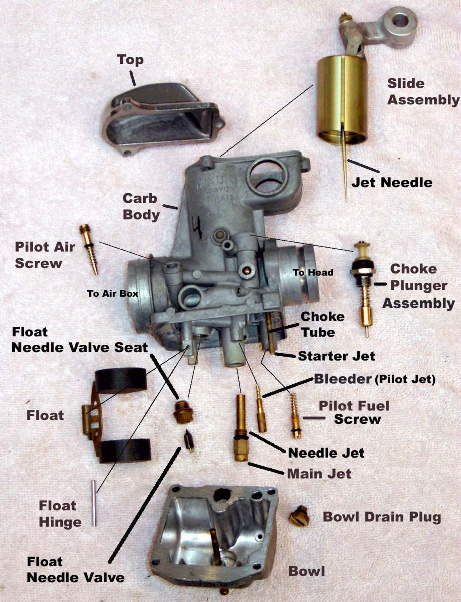

As its been stood for 25 years you need to 110% sure all the carb passages and jets are 100% clean. Old fuel leaves a varnish when it dry's. Ultrasonic cleaning will dislodge the varnish but it wont remove it from the passage. You need to get high pressure air through them to get all the old shit out after a sonic bath.
When you think they are clean, do them again to ensure they are clean.

Sounds like a disassembly & deep-cleaning of the carbs in an ultrasonic tank is in order. Even if a probe will pass through a tiny orifice like a pilot jet, that doesn't mean it's really clean. There can be residue on the orifices walls that reduce/restrict the effective size of the jet's orifice. Ultrasonic action in an appropriate chemical solution will reach deep into such recesses and remove residue & microscopic debris.

Running with choke on spells lack of fuel. Old faithful test is shooting carb cleaner in the airbox. If it then runs in modes it didn't previously, it's definitely fuel. Probably still clogged jet's and/or passages. I'd replace the jets.

No eBay APP ID and/or Cert ID defined in Kunena configurationThis is what it should look like although the thread looks badly worn on this one. But it gives you some scale. It adjusts by screwing into the holder. In increases idle, out decreases idle. Are you sure its not just unscrewed to the point of not touching the cable butterfly?
