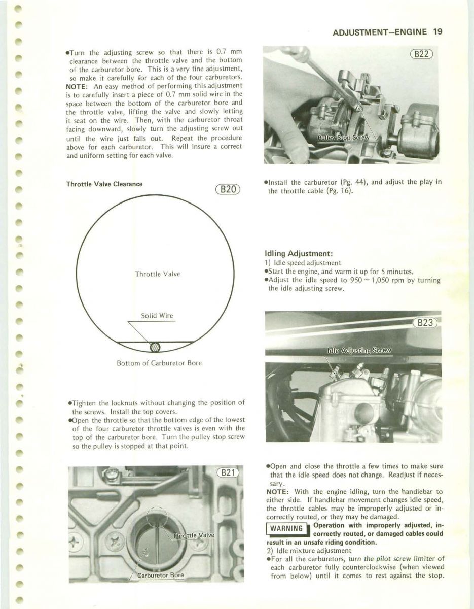

No eBay APP ID and/or Cert ID defined in Kunena configurationThis is what it should look like although the thread looks badly worn on this one. But it gives you some scale. It adjusts by screwing into the holder. In increases idle, out decreases idle. Are you sure its not just unscrewed to the point of not touching the cable butterfly?

That's what it looks like. I screwed it completely in and it doesn't touch. if I removed the spring, it might touch. There's maybe a 1/16 inch to 1/32 in ch gap. Not much. But enough. Or ... not enough. Depending on whether you're a pessimist or optimist. lol

Set it in the center of it's travel then adjust the slides using a small drill bit or wire. It's called bench syncing.

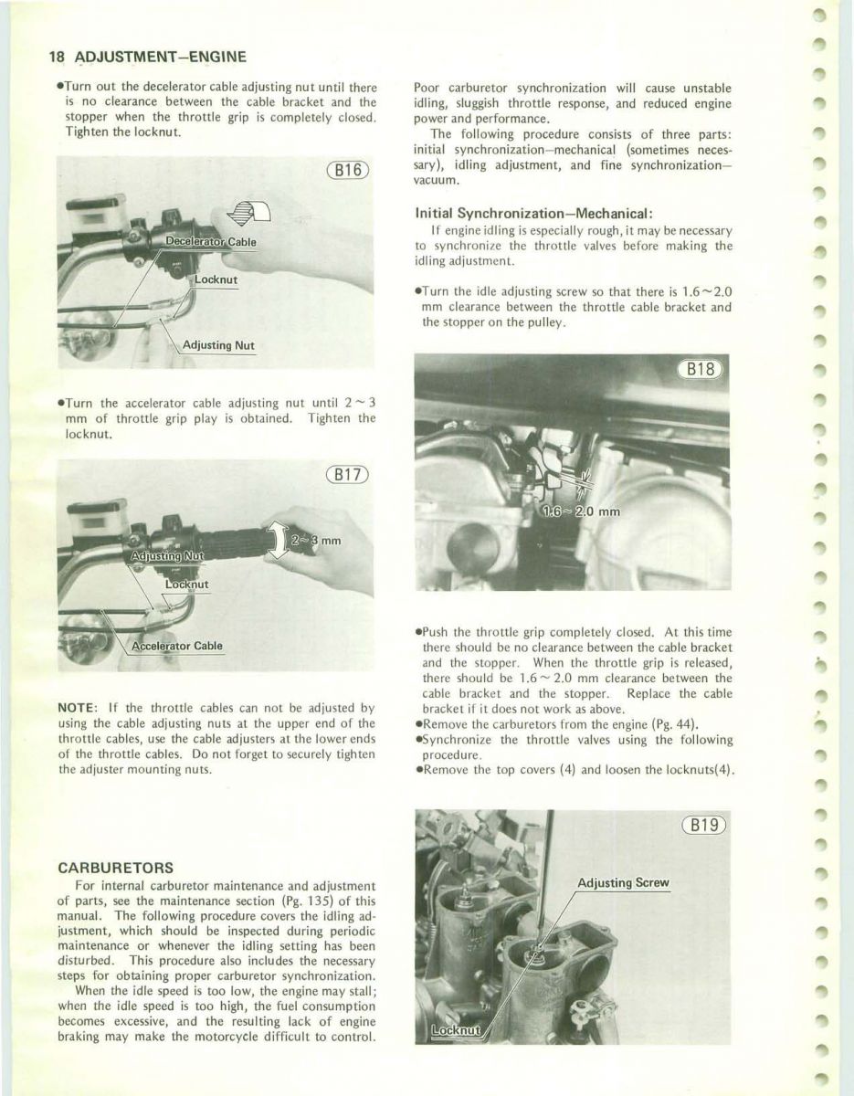

A common reason for the idle adjust screw not contacting the bellcrank is the wrong (too long) spring OR someone attempted to bench sync the carbs and used the adjust screws to lower the sync assemblies too low. In this case, first bend back the washer things on the M5 hex head screws. Loosen the hex head screws with a 7mm socket. Then loosen the locknuts on the adjusting screws. Back all four out and then tighten them till the slides barely touch the venturi. You MUST do all four. Now tighten your idle adjust screw so it opens up the slides just a tad. Now use the sync adjust screws with flat screwdriver to tighten them to just closed. If you leave an eyelash opening and the same on all four slides you can now tighten the hex head screws first then then hold the adjuster screws with a flat blade screwdriver and lightly tighten the lock nut. Bend the washer thing back up over the hex head screw so it doesn't loosen.
Now open your slides and you will note the assembly is bench sync'd. Open about an 1/8" so the bike will idle high when started and you will have to throttle it down once warmed. Don't put your hand on the throttle when using the choke.
