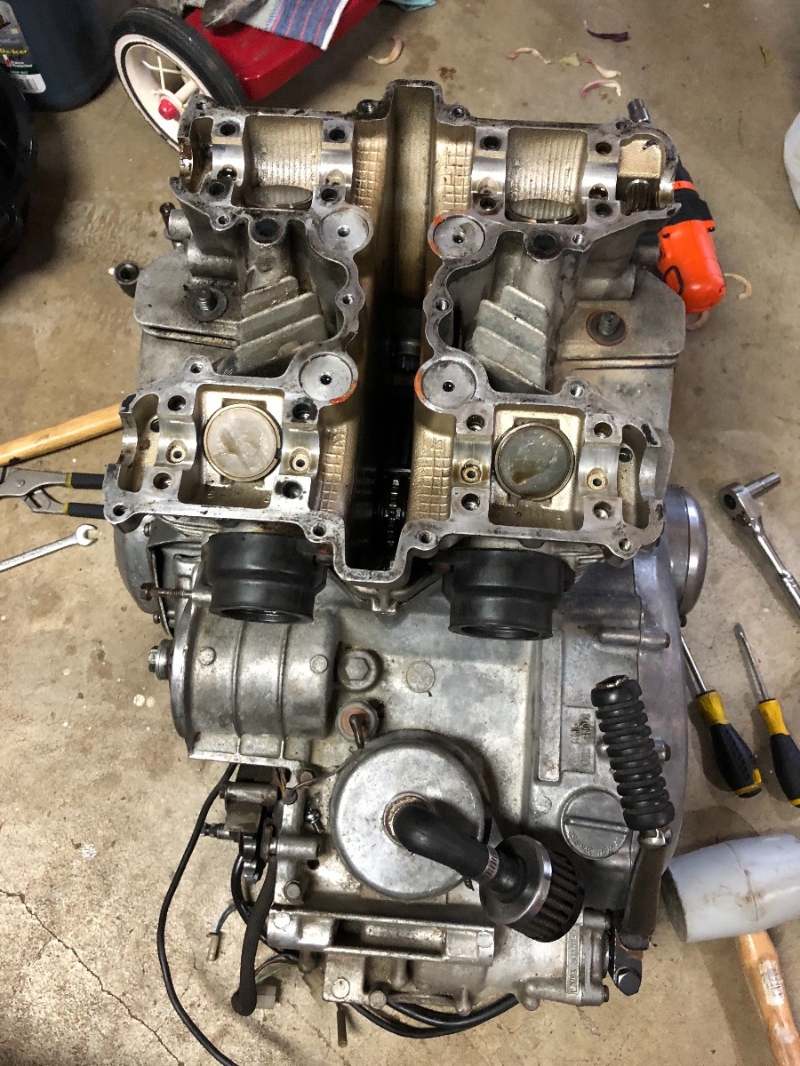

I ended up getting the engine out of the frame. I didn't have the right tools to take off the drive chain, so I cut it off. There was no easy way to work it off the sprocket.
Since then I bought an automobile engineering stand. Has anyone been able to fit a motorcycle engine to fit into a standard engine stand?

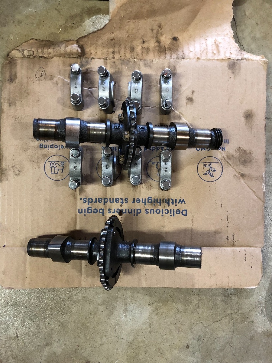

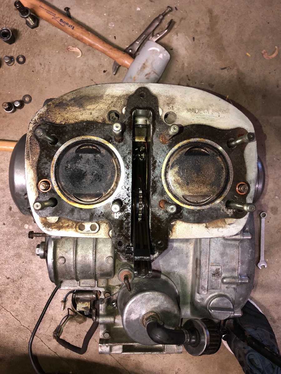

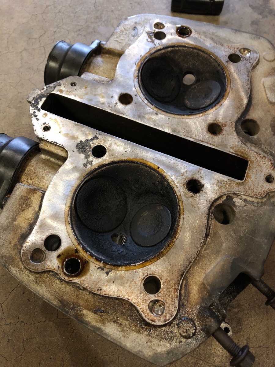

Once the engine was out I took off the valve cover, starter and cam gears. It took me a while find the plugs that hide the additional 4 head nuts under the slugs. Once I was able to get the head off and inspect what's going on in the engine. The valves look decent and I don't see anything alarming on the Piston heads.
Take a look and let me know what you think.
Last edit: 14 Jun 2018 09:00 by Kaz. Reason: Attach files
- Posts: 8205
- Thanks: 3577
Re: Cam chain broke. Where do I go from here?
14 Jun 2018 10:44
Looks remarkably good for an engine that broke its cam chain. I was expecting some valve to piston impact marks at minimum. Humm...

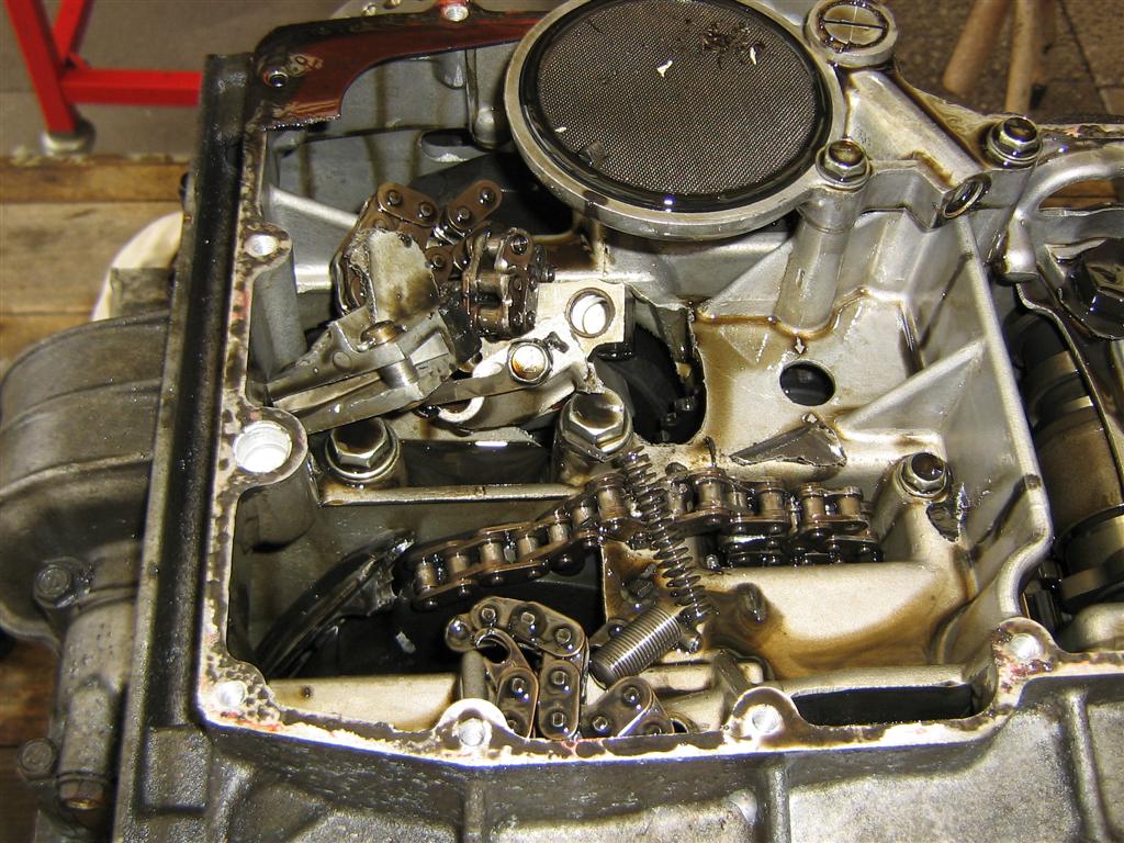

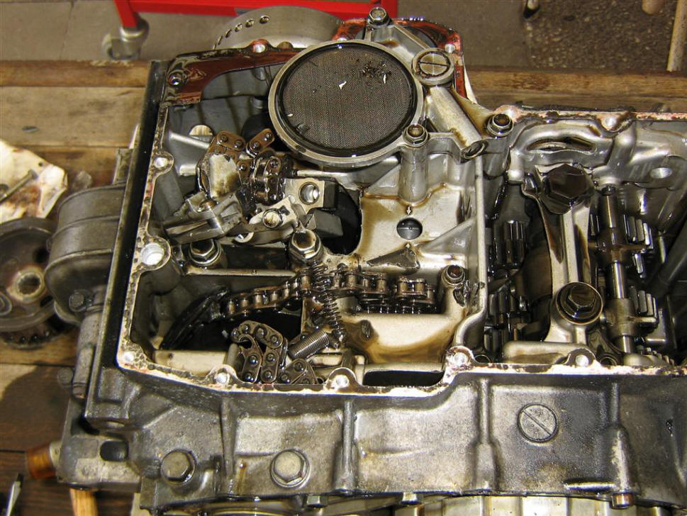

14 Jun 2018 13:50 - 14 Jun 2018 13:52
Head, pistons and valves looking good.
....but the bottom of the engine?
I have a bad feeling...
www.z750twin.de/zylinderkopfdichtung.htm
www.z750twin.de/getriebe.htm

Looks like valve guide seals. What do the bores look like.
