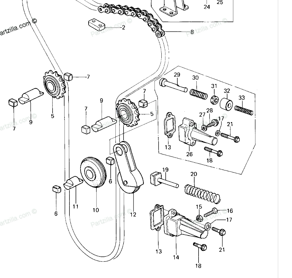

Hi new member here, I recently bought and am currently rebulding a 1978 kz650-b2 and the previous owner lost the bottom cam chain roller (part number 12055-004) along with the accompanying shaft (part number 12052-003) the only cam chain rollers I can find online are for >$100 on ebay. Does anyone have one they would be willing to sell me or have any suggestions on acquiring one? Im a highschool student and I dont have the funds to spend on this one part. (yes I looked at partzilla and it is out of stock and would rather not wait months for them to get more in stock)

#10 and #11 are the parts i'm looking for

Did you also find the little blocks, #6 in the image above?

TexasKZ wrote: Wow! Good catch.
Now would be a good time to be sure the filter screen on the oil pump is clean.
Yes, I all of the damper blocks luckiy
