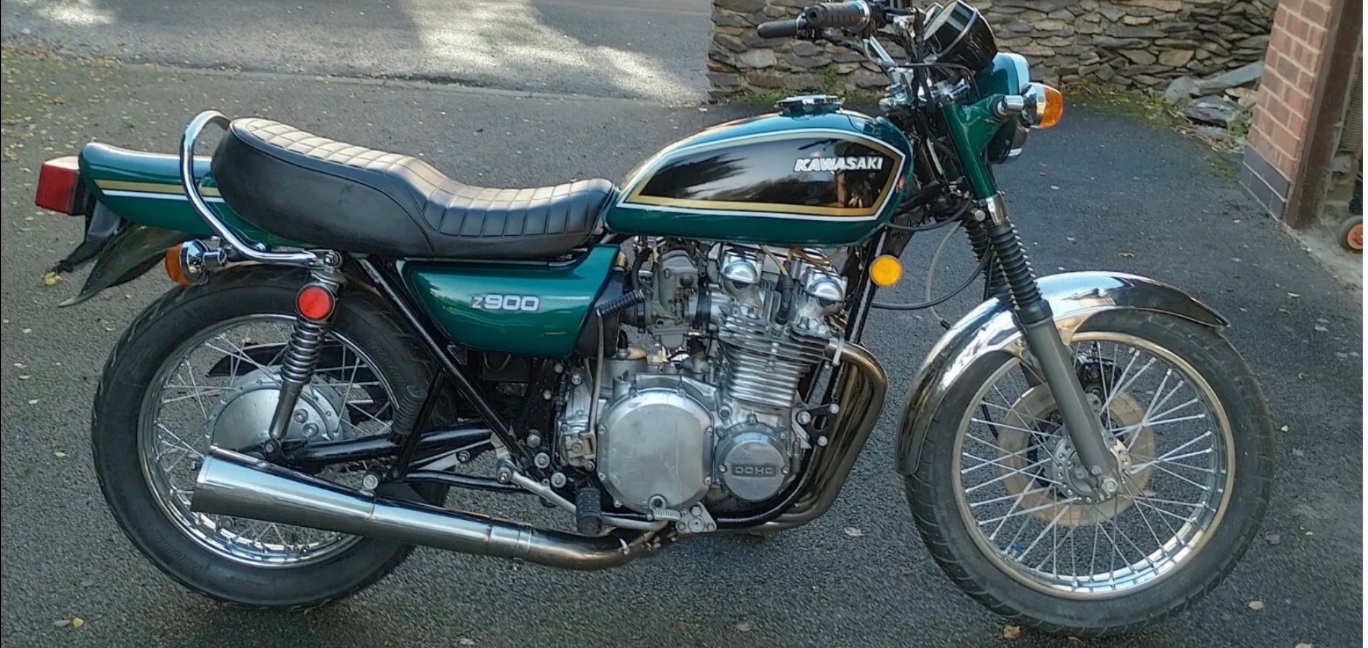

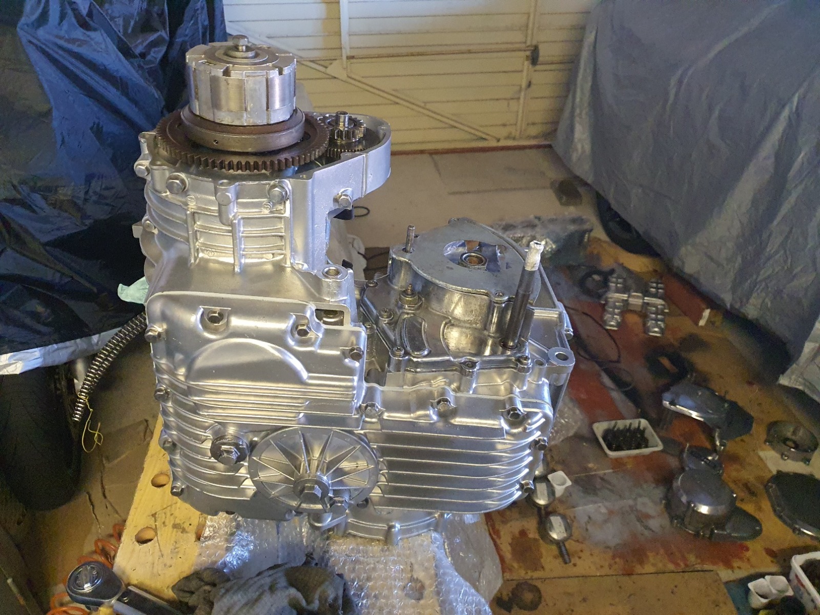

1st photo as it was when i bought it, 2nd photo engine vapour blasted on with rebuild.
