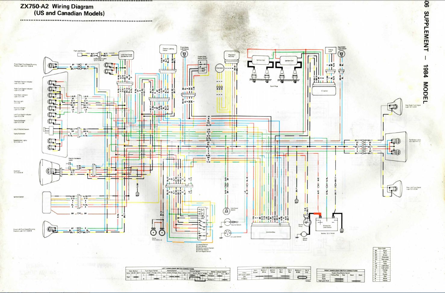

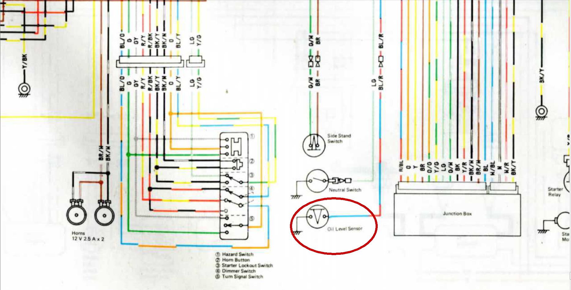

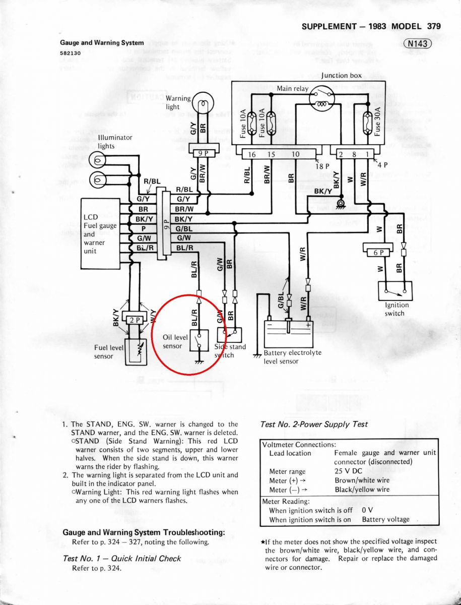

04 Feb 2018 12:16TexasKZ wrote: Oil level switch
hows it wired then? no terminals
ZN750 Ltd Shaft (non-USA)

- Surt
- Posts: 125
Re: '84 KZ750LTD (Shafty) cams timing problem
04 Feb 2018 19:35
so wires are to be connected to m6 screws, gotcha Scirocco, thanks mate!
