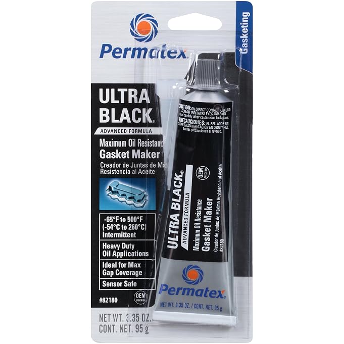

www.amazon.com/Three-Bond-Liquid-Gasket-1184A100G/dp/B007TWXI1K
Or go down to your local autoparts store and get this...for $5. Be sure to clean the half moon and engine surface with acetone/brake cleaner/alcohol first, before bonding.
