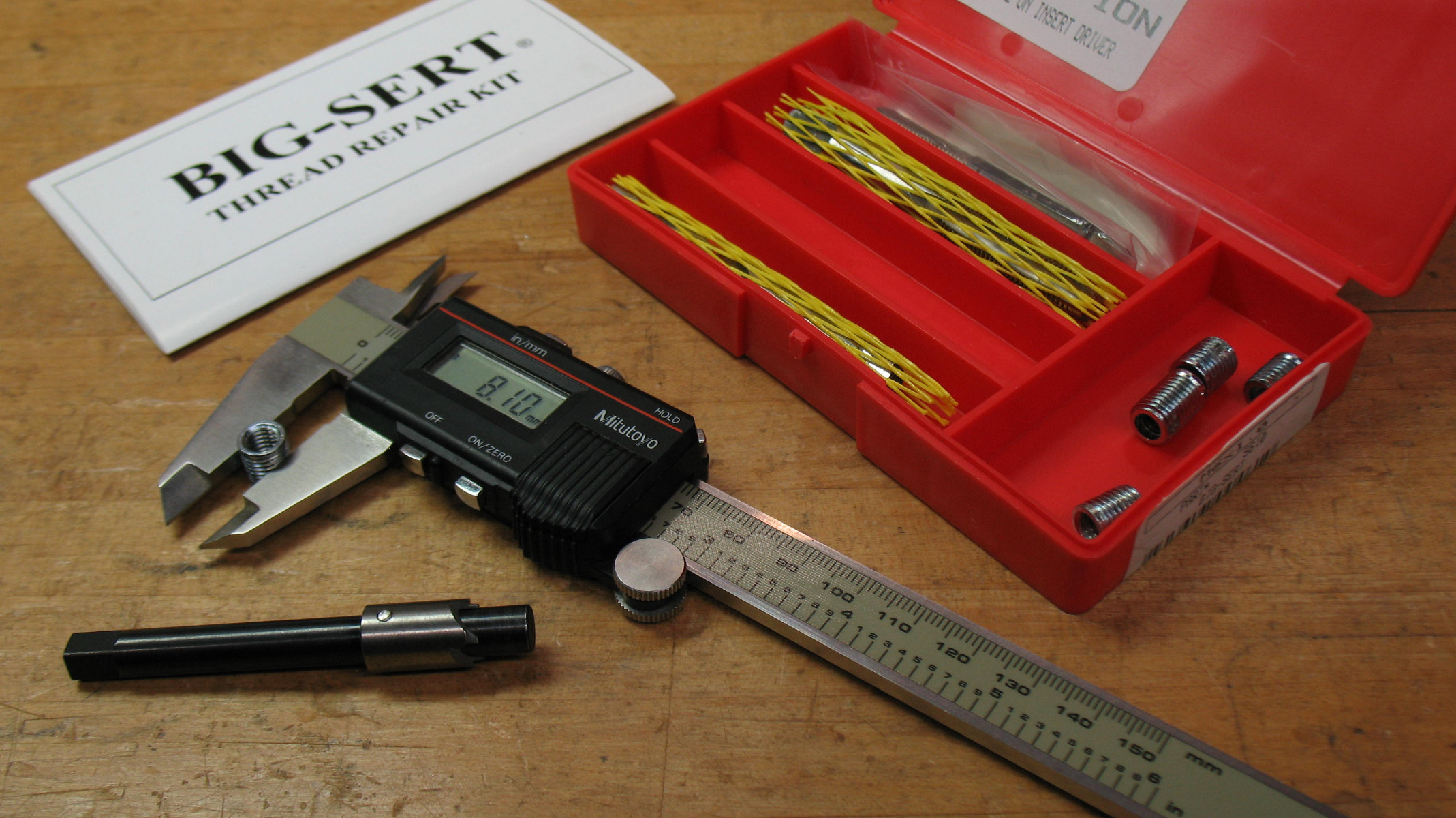

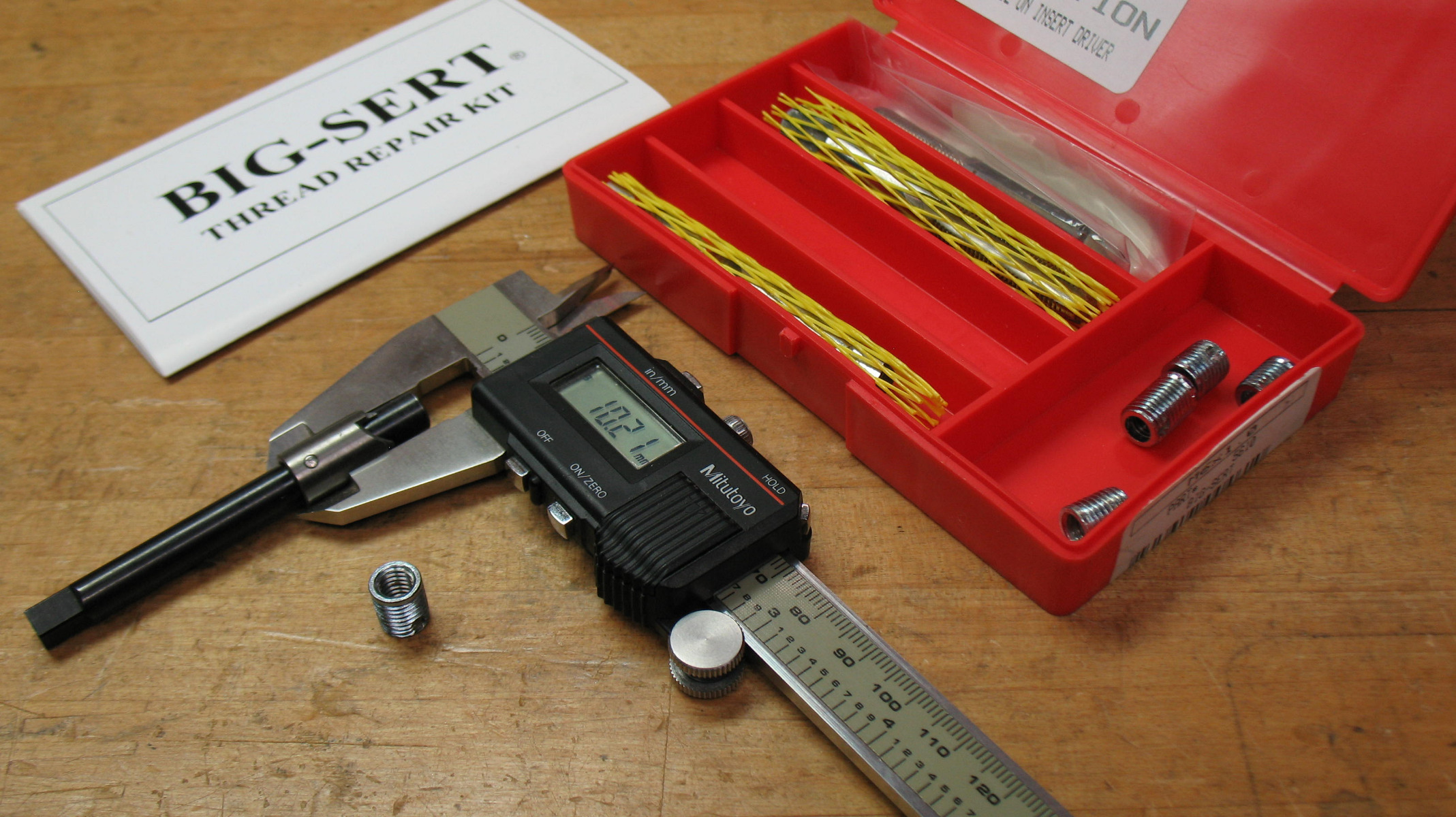

Can a successful Big-Sert repair be made without using the flange tool (shown in picture), to avoid affecting the dowel-bore portion of the hole itself?

The dowel is 8mm, so no, Big-serts cannot be used without negating the dowel. However the standard time-serts can be used with the dowel.

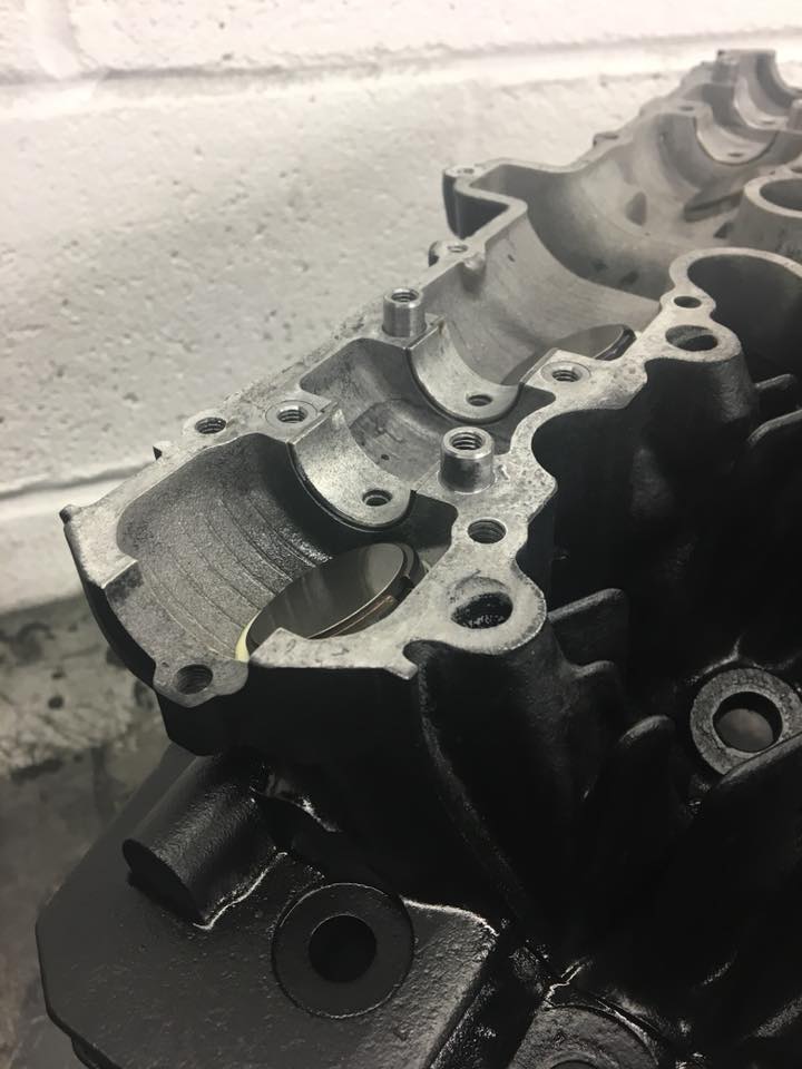

10 Feb 2020 12:17zed1015 wrote: If you haven't a lathe.
You can drill and tap to M10 max ( decent pillar drill needed )
Then fit a solid steel M10 slug flush with the head. ( use M10 x 1.25 or 1.5mm threaded bar, studs or bolts as slug material )
Bolt on the cap and use the hole as a guide to get the center for drilling and tapping back to 6mm.
Once done you can then drill 8mm to take the dowel.
The success of this obviously relies on your skill, accuracy and mechanical competence etc
If you have a lathe you can make the whole slug and location dowel in one piece as in the attached pic.
I'm just about to do a head that needs all 16 doing.
I done some of those for Mr Puffin on our UK Z1 owners Rob, still running the motor as far as i know.

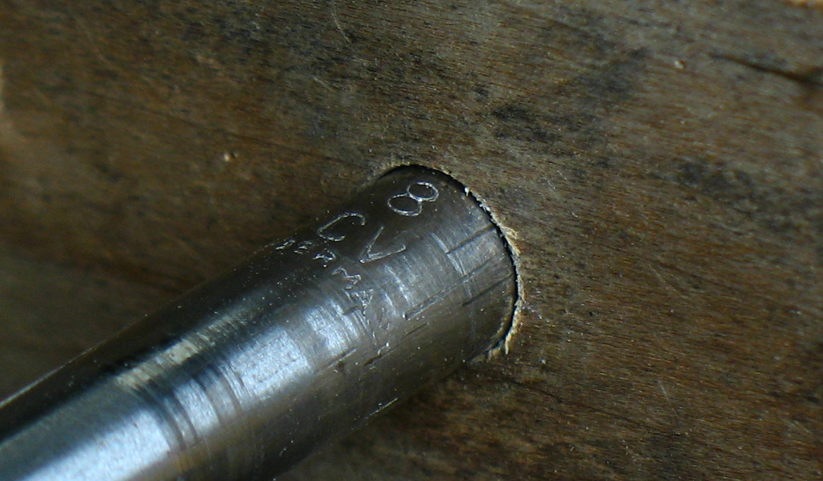

Kray-Z's "thoughts and experience" support my theory for the Big-Sert system for a simple-effective repair.
If I were facing this fix, I'd attempt the repair with it since I already have the kit. There may be a few unforeseeable glitches, but for the purpose of retaining the dowel it should work nicely.

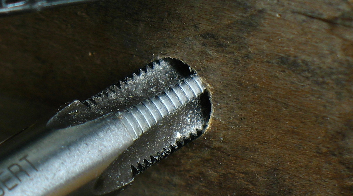

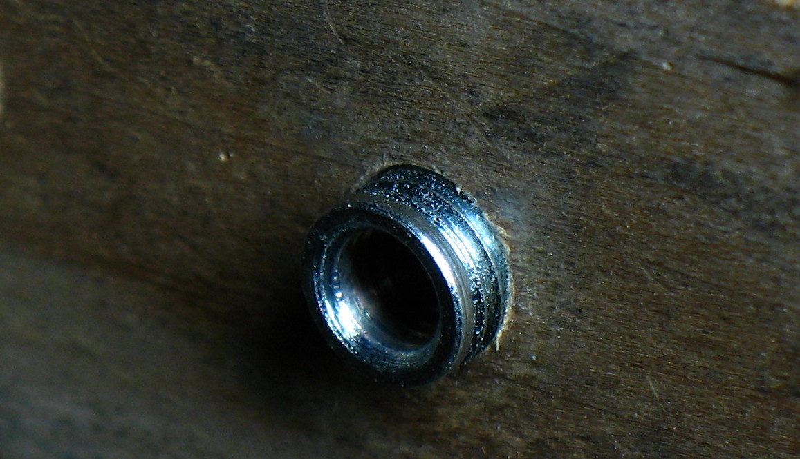

To illustrate, I bored an 8mm hole in a block of hardwood, and followed with the relative Big-Sert installation steps.
The Big-Sert tap cut a shallow thread into the bore wall. leaving ample untouched surface to support the dowel in it's original position.
Kevski noted in post #776960, that the insert would need to be modified prior to installation.

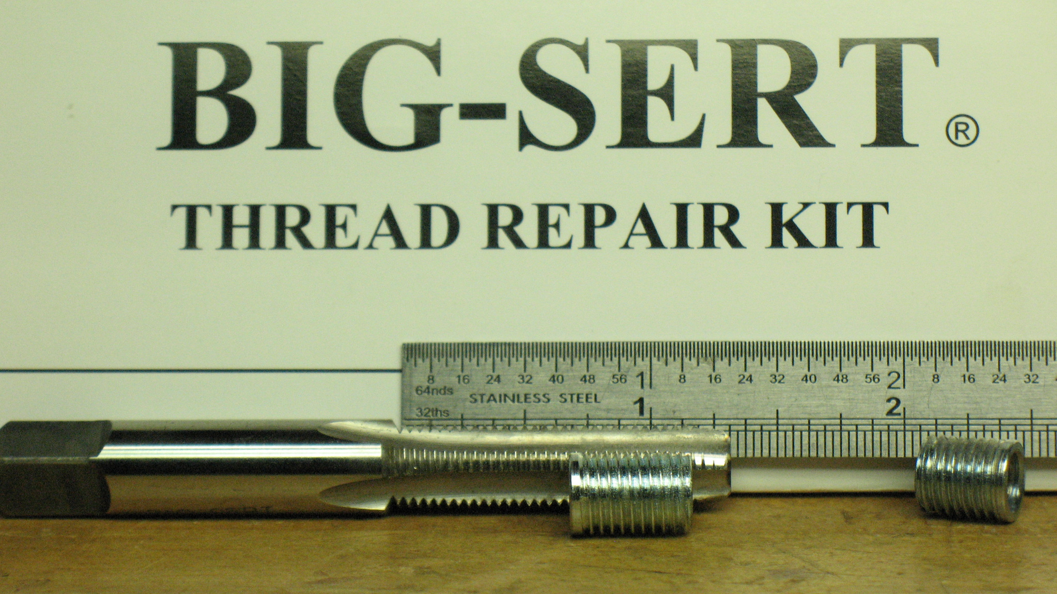

Big serts need a .330" (8.383mm) counter bore to seat which would remove the dowel location
