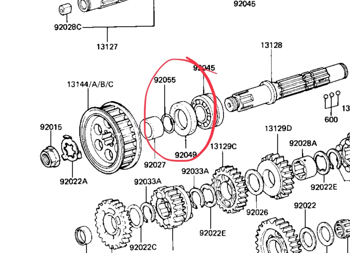

It's not in a cover but I don't think you have to split the case, looking at engine prints it doesn't look like it is held in by a lip or shoulder. Also be out of character for normal kawasaki approach for that seal.

No lip on that seal, you should be able to just pull and replace like any other case oil seal. Always fun getting a 35 year old seal out.
