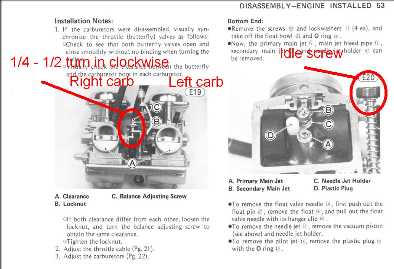

The right carb need some more throttle (no poppy sound).
You have to sync the carbs,
The left one is the master (only adjust by idle screw), the right one is the slave and has to be adjust by the balance adjust screw to open or close the right butterfly to get equal vacuum on both ports.
Turn the screw 1/4 - 1/2 in to get same poppy sound on both.
No need to remove the carbs, you can do it on engine idle.

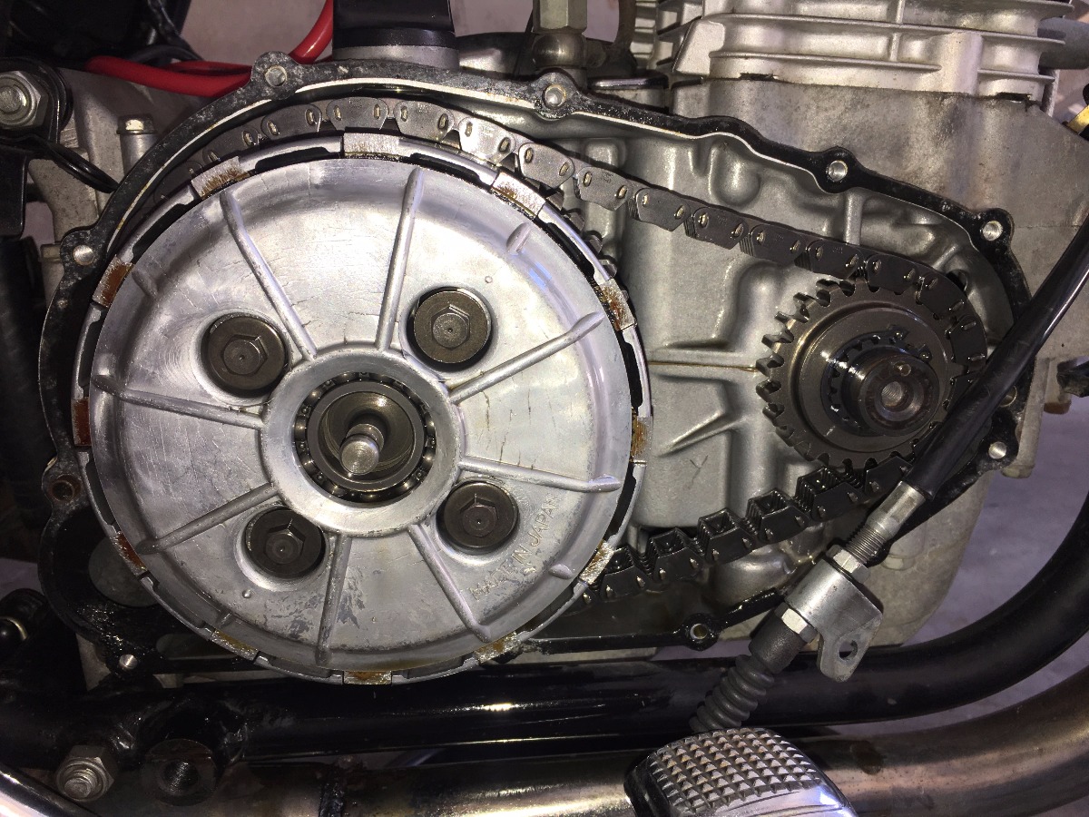

Remove clutch cover and have a look in there that is not a good rattle if nothing rolling around in there sump cover, then top cover but definately needs internal investigation.

So I opened up the clutch cover. I don't see anything obvious rolling around in there but other than that, I dont know much about the clutch yet so I wouldnt know if anything was wrong with it by looking at it. .

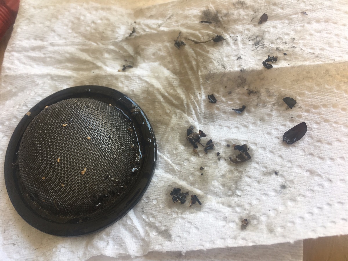

Opened up the sump and found some crusty crap in the filter. Looks like varnished old gunk chunks and some white specs of something soft. not sure what either are from though.
Nothing big and metallic or plastic that would, in my opinion, have made such a large rattly sound....

I found pieces like that in the sump once and found that the
chain guide was old and falling apart.
