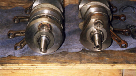

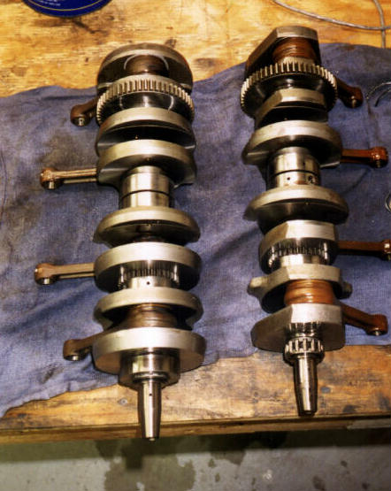

Off the top of my head the 900s came with pork chopped crank journals and the 1000s came with round crank journals. My crank was lightened by Falicon by carving my round 1000 crank to resemble the 900 crank. ( Lots more goes into it but that is the short version . ) So 900s dont have the same mass as 1000s so they can rev up easier
