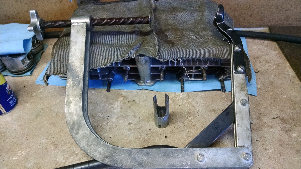

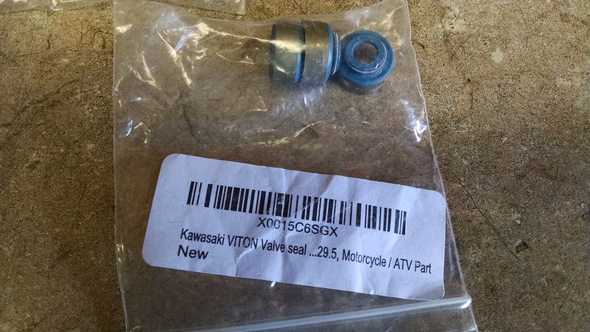

I am big on OEM parts my friend. AND.. some new viton valve seals are already sitting here. Check out the valve spring adapter I made for my valve spring compressor out of a short piece of 1" EMT. I may tack weld it to my valve spring compressor, depending on how things go when I get to the head / valve lapping. I am STILL spending every waking moment cleaning, ordering, scraping, stripping cylinder base gaskets.

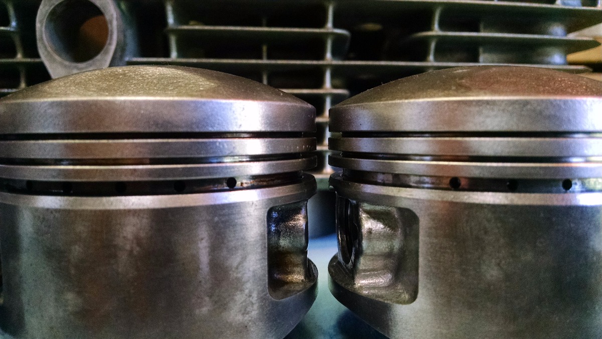

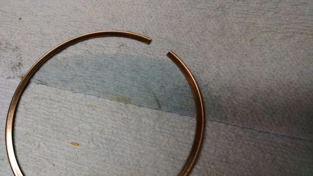

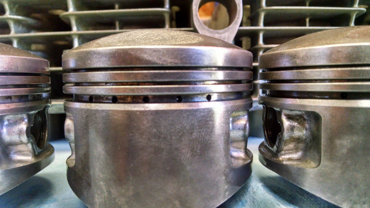

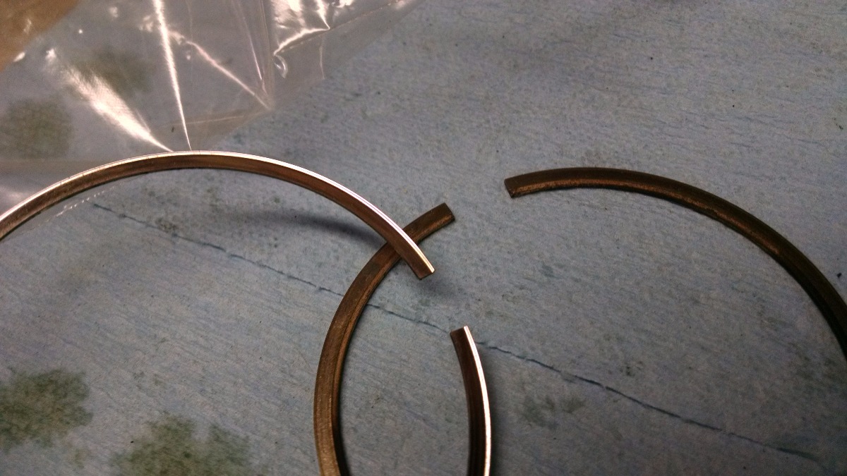

Here are a couple of pics took of the rings last nite. I tried to get in focus good enough to see the top ring wear. This is a new one on me finding a ring wearing like this. It had acceptable compression ranging from 135-155.#. 1 & 2 were the lowest with 2 being ~135#. This bike has 22K miles. I have been running Rotella full synthetic 5W40 oil for maybe 5K miles or so. The cylinder walls look fine and will deglaze well,. I hope.

What do the piston ring lands look like?

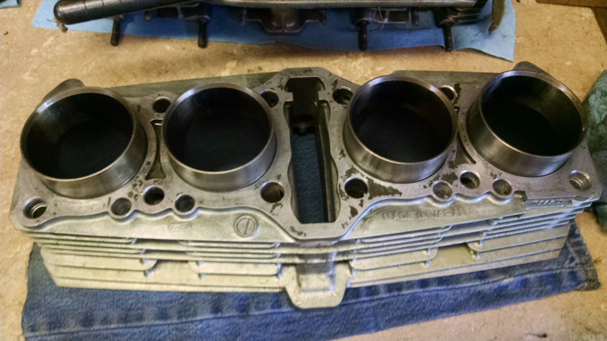

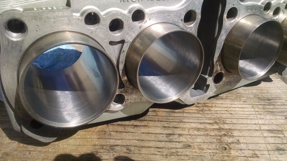

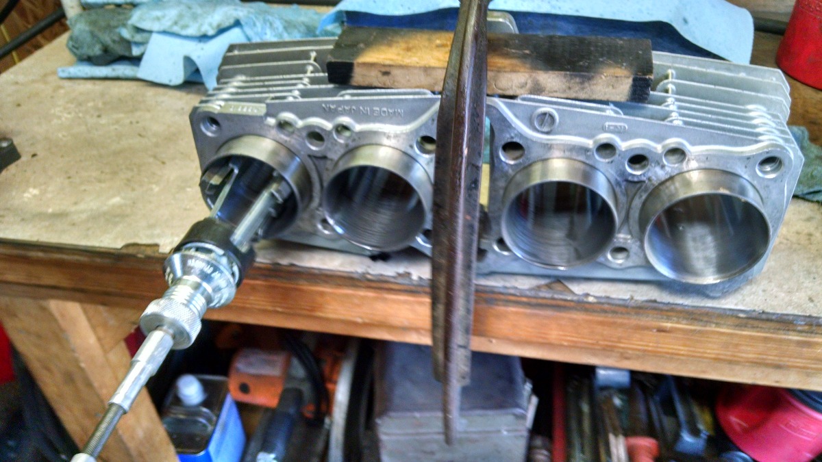

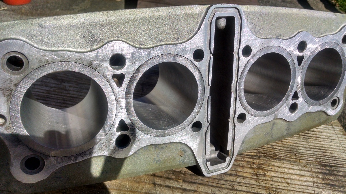

10 Sep 2017 13:50 - 10 Sep 2017 13:55SWest wrote: What do the piston ring lands look like?
Well, I spent the afternoon cleaning / inspecting the pistons, and did a light hone on the jugs. It's really hard to tell if the ring lands are out of tolerance without having the rings here yet, but visual inspection.. they look ok, and no visible wear is showing in the land areas. I tried to get some good close up focused pics of the ring lands I am posting below.
The cylinders seemed to clean up well, and did show some upper and lower ring ridge, but not much. I did hit them all a few times until the ring ridge shading was no longer visible. Whatever the ring ridge was (I don't have the tools to measure the bores), it was negligible. I feel the cylinder assembly and pistons are ready for reassembly.
