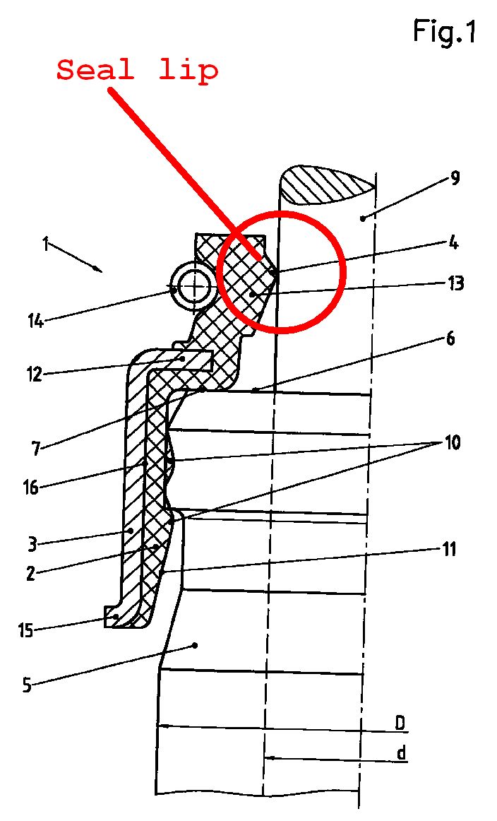

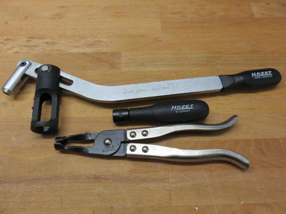

Re: KZ Mystery. Guru Needed
05 Sep 2017 22:38
The valve stem seals do the hardest job of all engine seals.
The heat and the age of decades made them hard as stone and so they lost their sealing properties.
There is only a small lip on the seal that hold the oil away from leaking (sucking) down the stem into the
combustion camber and then burned away,.
I my self changed valve stem seals more than 100 times for me and my friends cars and bikes without removing the head .
and after the seal job the oil consumption goes nearly to zero between the oil changes!!!
