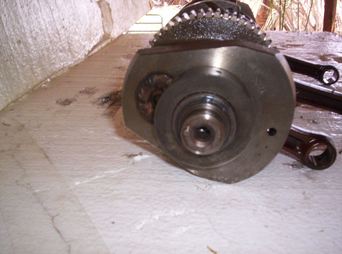

Has anyone seen an 83/84 18mm pin crank welded from the factory ? Been told they don't exist but I've come across at least three out of stock GPZ 1100 engines. Still have two.

no the crank are the same except for the rod ends, 18mm but the welding is puzzling

I've had several cranks welded for race applications also but if you would put the 3 cranks with the ignition side facing you and the ignition alignment pins in the same position (say 12 o'clock) the welds would be in the exact position, same size and quality as if done in factory. All the motors seemed untouched. Interesting .
