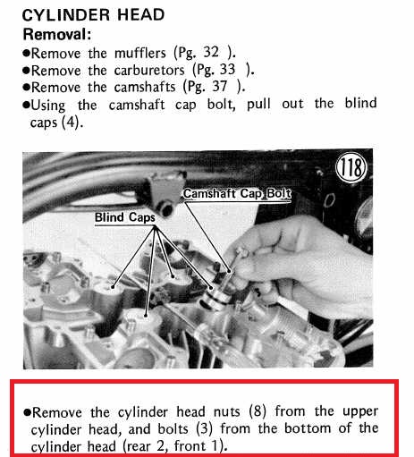

Are you positive you removed all the cylinder head nuts and bolts? According to the manual there are 11 of them. Ed

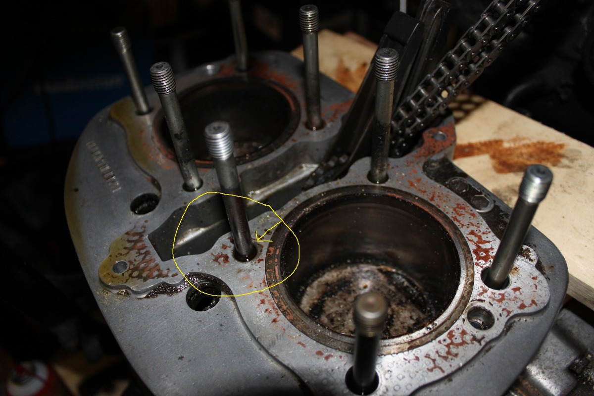

The Head is off, all the nuts and bolts are removed. I think the problem is the bolts sticking up through the block are rusted and locked the block in place. I think it might be one or two. I heard this is common with these engines because water can get down the shaft and cause the bolt to rust, locking it in place. I put some CLP Breakfree military rifle cleaner down the shafts for 24 hrs but not sure if it is working. Maybe a better product for disolving rust?

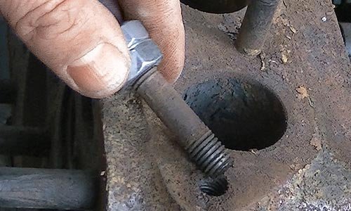

Okay, you can try to turn the cylinder blots out a little bit to loosen the rust by countering two nuts on it.
