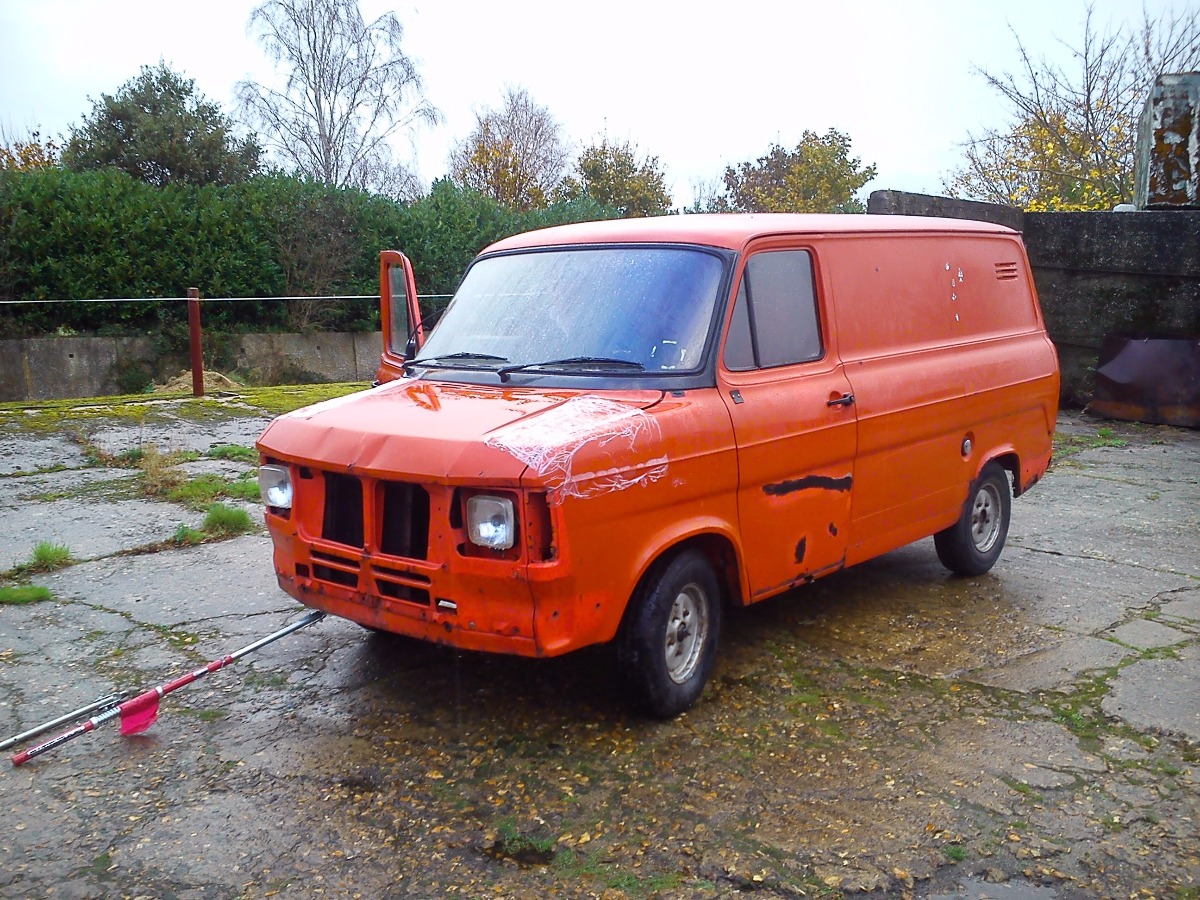

Hi there again. I've taken the barrels off(jugs to you Americans!) & Even though I tried with a vacuum cleaner to suck out any debris, a fair amount of junk fell into the engine.
I've got most of it out but I bet there's still a lot of nasty news still inside ! Is there any way I can flush out y removing the sump ?
Also I'm pretty much sure that my oil leak is coming UP the stud from the threads as some of you said.
Bought some 3bond to repair it with.
Last thing, the tiny rubber cam chain idler dampers & the ones that fit between the middle cam sprocket are rock hard (no cracks though) should I replace them of am I being paranoid?
Hope you're having less problems than me!!!
Guess the make of my van !

Van: Ford?

Ford Transit mk1 cool first vehicle ever traveled in, as a baby.
