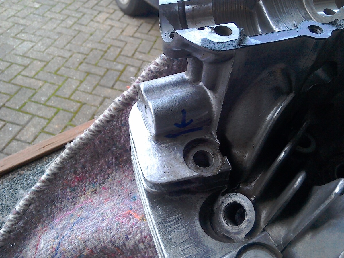

It WAS a hairline crack in the head after all.
Special thanks to scirocco who first spotted it!
I bought another head, stripped it down totally except for the valve guides.
Cleaned up the carbon, ground in the valves, did the shims (great fun)
Got it back together & now no leak !!! Yippee.

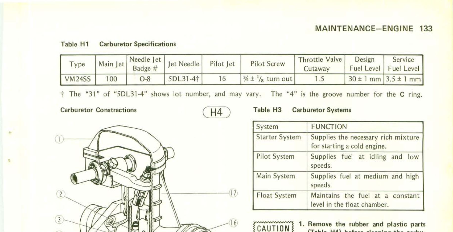

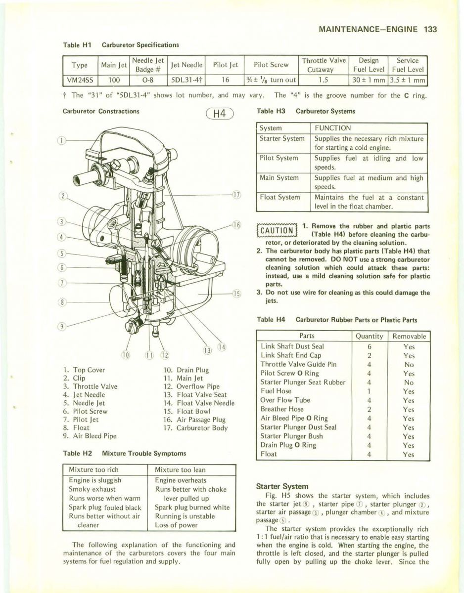

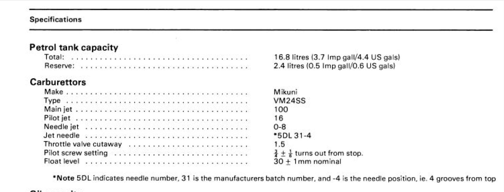

Can anyone advice me how many turn's out I start with .

All i could find for the 24 carbs are the underneath air screws adjustments
Air screws adjustments on the side of the carbs could be different like 1 1/4 - 1 3/4 turns out.
