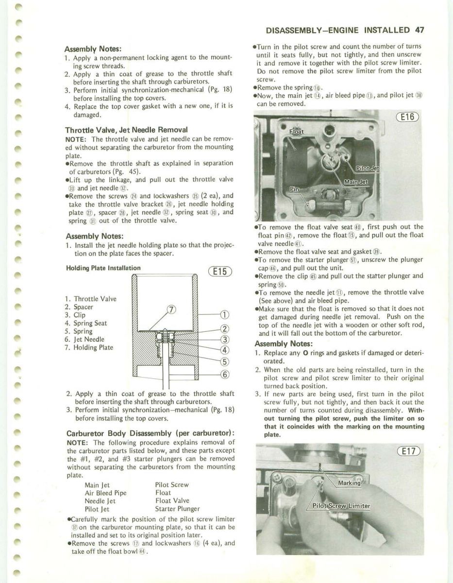

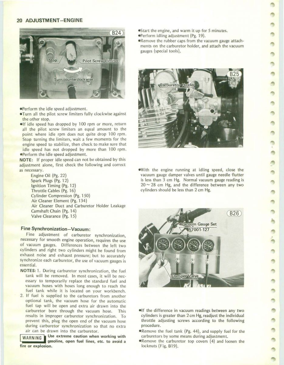

Hello,
yep, 1st spark plug was dead
Now i have the good engine sound !
Do you know how much turns i have to turn the carbs pilot screws please?

Re: problems
22 Jun 2017 14:30
I don't know, but there might be some info in one of the manuals. Here's a link to one of them. Ed
www.kzrider.com/modules/ServiceManuals/K...Service%20Manual.pdf
Re: problems
22 Jun 2017 14:38 - 22 Jun 2017 14:41
Last edit: 22 Jun 2017 14:41 by Scirocco.
