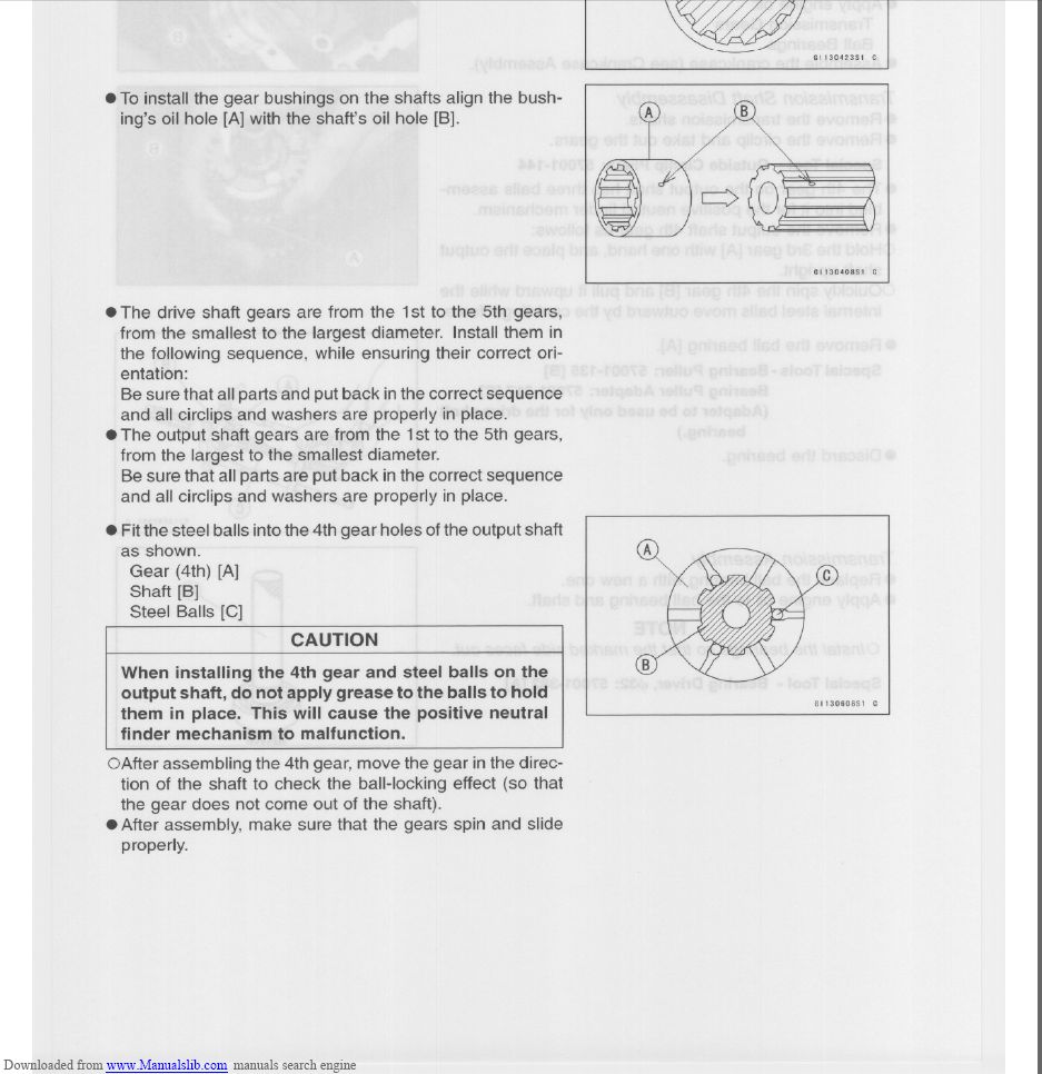

What TexsasKZ try to explain is, you can´t shift in the higher gears without rotating of the output shaft ( front sprocket ) or
rear wheel movement.
There maybe a safety device, a switch at you clutch leveler ( have to pull ) and the side stand ( in riding position )
to prevent an engine start ( no spark / no electric starter motor ).
