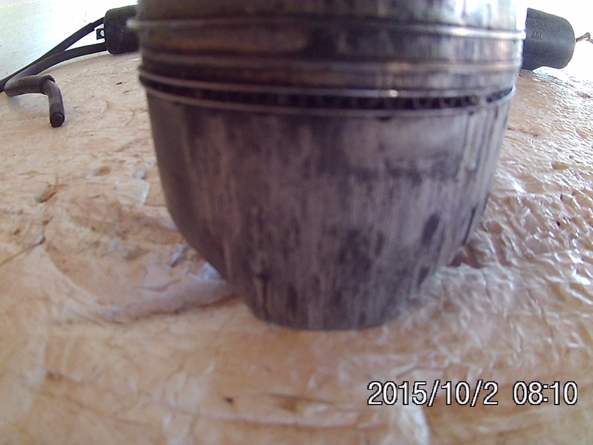

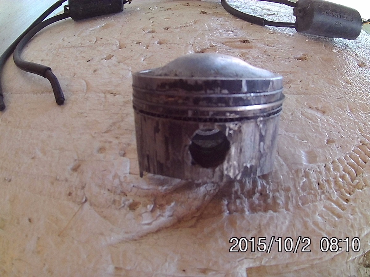

This is #1 piston when I ran it out of oil in 13. STUPID. You can see most of the wear is on the right side facing the journal with the broken pin. I'm still running the others. They were undamaged. I didn't realize how bad the valve guide seals really were. I was planning to order a new sight glass and the idiot light was undependable. I knew better and wound up cleaning the old one with carb spray and Q tips. It's still in use. I try to stay on top of things now.

Man, you got your money's worth out of that one.
