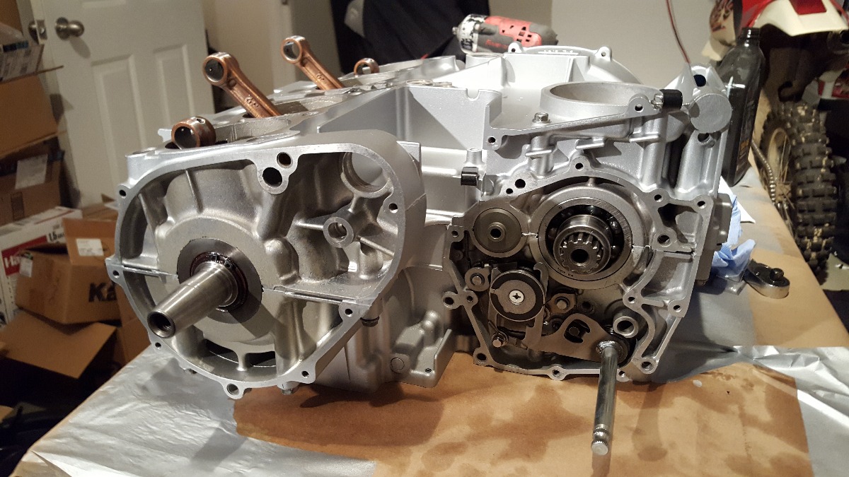

Stan at Gardner racing is getting ready to ship back the crank. He said it was still slightly twisted, and the two foot wrist pin through the rods is not an accurate way to check for twist. He also replaced the thrust bearing which is the weak link. I think the slight twist, causing .0025" runout at the center, was the cause of the tight spot. I'll know for sure when I get it back and bolt it into the case.

Finally bolted the crank I got back from Stan Gardner into the case, and guess what? It's perfect. The tight spot was from crank twist, Using the 2 foot wrist pin to check for twist is not accurate. It will fit through the rods anyway, unless there's a major twist or a bent rod.

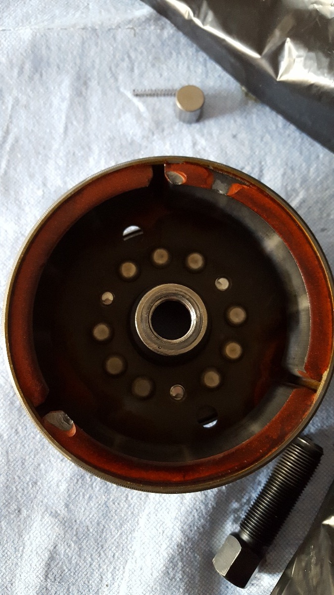

OK. Round 3. Got the crank in and halves together, and everything is good. I tried holding the alternator rotor with a strap-wrench to torque it -- but it's not going to happen. Anybody got a work-around or cheap tool? I got the bolt to about 75 ft/lbs and could still see daylight between the damper and the case. I have the thinnest one in there now, and will have to go up to the standard size.
I noticed some insulation chipped off on the rotor magnets, but i'm assuming that's nothing to worry about. Also found a lot of metal particles stuck to the magnets, and got it all out with air.
Any experience with the cheap aftermarket stators? Mine was leaking past the wires. I know I can probably get it sealed, but a cheap stator would be a lot easier if they're any good.

I borrowed a rotor holder from a local Kawi dealer. Torqued to specs and with crank endplay pushed all the way to the left the flywheel had no drag at all from the damper washer. Went with the next size up ( standard/7.3mm) and the drag was there.
Seems like a lot of folks overlook this adjustment. My buddy that worked on all the P bikes for years said you'll get an endplay rattle at idle if no drag from the damper. Eliminating and cushioning endplay by pulling the crank to the left is the whole purpose.
