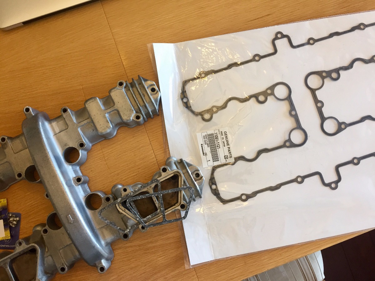

I have done the valve adjustment on this bike and am almost ready to replace the valve cover. Do I need to do anything to the gasket or these new reed-valve gaskets before I bolt everything down? Is it possible to put the gasket on upside-down or backwards?

10 May 2017 09:01I am curious about that cam cover gasket, if the squiggly lines on the surface are a heat-activated sealant?
That feature and the graphite coating may seal better than plain gaskets, but that stuff peels off and stays behind on the motor.
The clean-up is tedious, while trying to keep the gasket-graphite scrapings from falling into the engine.
Did mine last night, and an oil-change w/filter is next on the agenda.
Always good to check the valve lash clearances while in there...
It does look like there is something on there. I can see that clean up could be a pain, but this one came from Partzilla so it should be good.

Had my bike for 35 years, and adjusted the valves many times. OEM gasket, all the way around the cam plugs with sealant, bolt it down wet, and it doesn't leak.
Never saw it in writing, but I always put the side of the gasket with the extra sections of sealant toward the head. And cleaning off the old gasket I keep a narrow nozzle of a vacuum up close while scraping to prevent junk from falling into the engine.

I don't think the gasket matters $0.02 which side is up. The way I do it is if the end plugs are not leaking, don't touch them. Put a little Yamabond #4 along the top of each end plug extending a little ways onto the aluminum, then install the gasket and cover and tighten it down, and job done. Now the good part, next time the cover needs to come off, be careful all the gasket is stuck to the head as it's being removed, and the gasket can be reused forever. I bet I had the cover off my KZ650 15 or 20 times and never replaced the gasket. Only time it needs replaced is when it gets broken for some reason. Replacing a cam end plug it takes a little luck to separate the gasket and plug successfully without breaking the gasket.

12 May 2017 18:09RonKZ650 wrote: I don't think the gasket matters $0.02 which side is up. The way I do it is if the end plugs are not leaking, don't touch them. Put a little Yamabond #4 along the top of each end plug extending a little ways onto the aluminum, then install the gasket and cover and tighten it down, and job done. Now the good part, next time the cover needs to come off, be careful all the gasket is stuck to the head as it's being removed, and the gasket can be reused forever. I bet I had the cover off my KZ650 15 or 20 times and never replaced the gasket. Only time it needs replaced is when it gets broken for some reason. Replacing a cam end plug it takes a little luck to separate the gasket and plug successfully without breaking the gasket.
Same here. I've owned my 1977 KZ650-C1 for a little over 40 years and I'm on my second valve cover gasket. Ed
