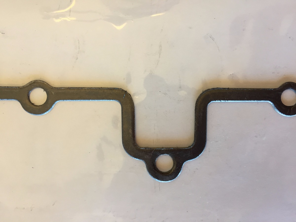

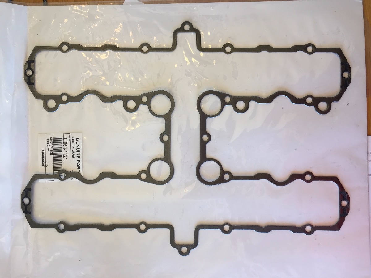

VTEC wrote: Had my bike for 35 years, and adjusted the valves many times. OEM gasket, all the way around the cam plugs with sealant, bolt it down wet, and it doesn't leak.
Never saw it in writing, but I always put the side of the gasket with the extra sections of sealant toward the head. And cleaning off the old gasket I keep a narrow nozzle of a vacuum up close while scraping to prevent junk from falling into the engine.
I think I see what you mean. I took the gasket out of the package and the other side looks like this:
This side doesn't look like it has any sealant so the other side must go toward the cylinder head.
Thanks!
