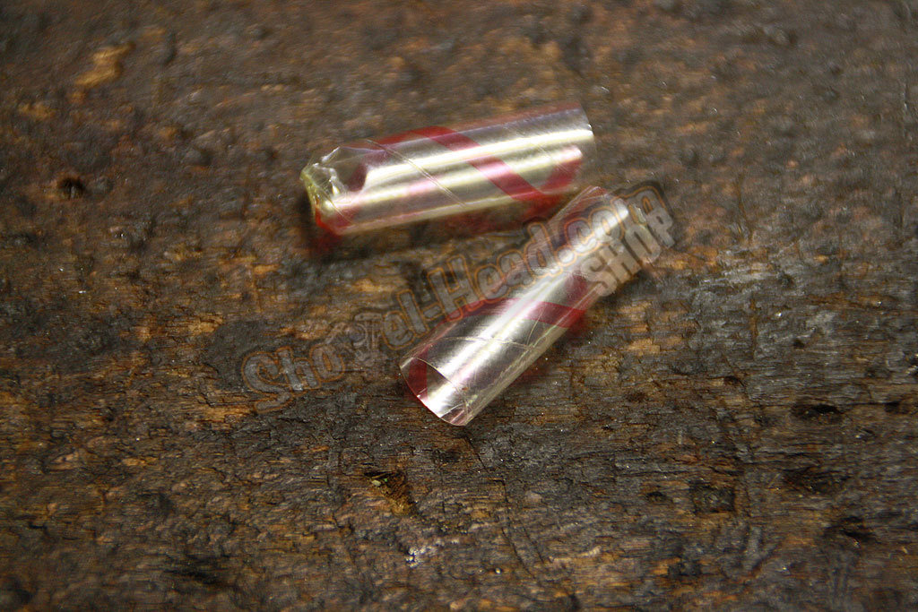

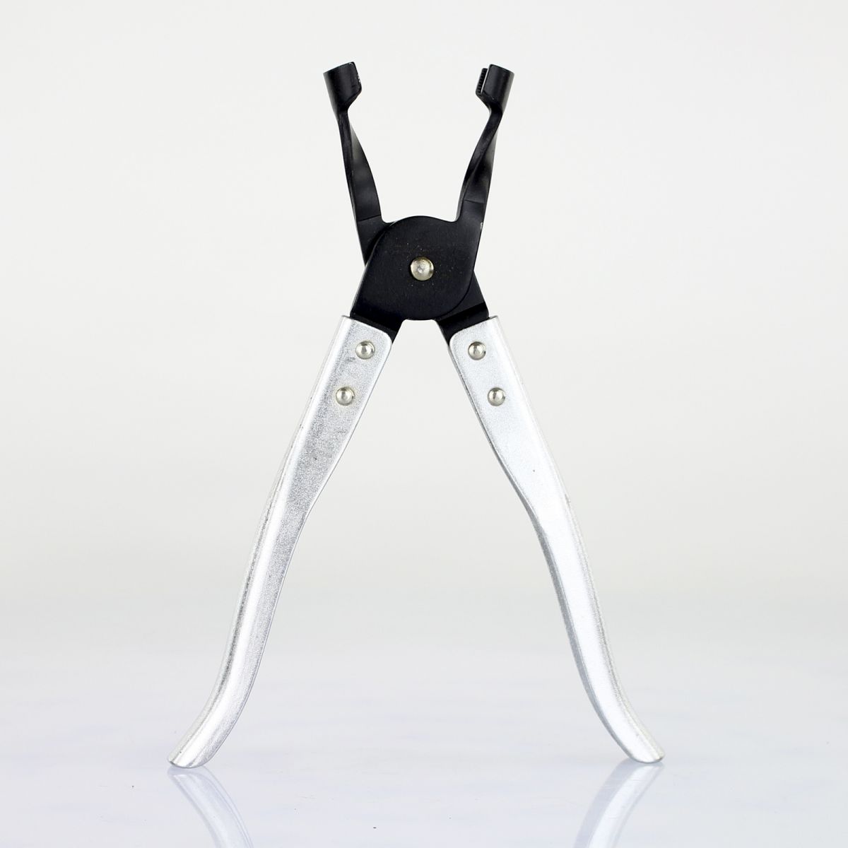

the Valve Spring Seat washer first on the bottom of the cylinder head then press the valve stem seal on the valve guide.
In a set of a new valve seals should be a plastic tube that secure the valve seal for damaging by the valve keeper grove.
If not use a suitable drinking straw.
Tool for pulling the old valve seals

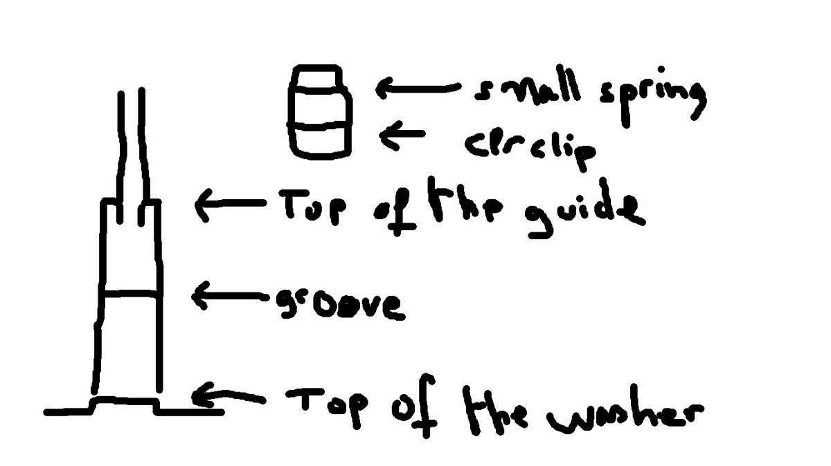

Hello;
so actually the new valve stem seal is on the top of the valve guide.
(i think it was like that for the old stem seal)
Picture :
1/ The "small spring" is on the top of the guide and the cerclip is on the groove.
Do i have to push more on the stem seal to have :
2/ The "small spring" on the groove and the stem seal touch the top of the washer
Picture :
