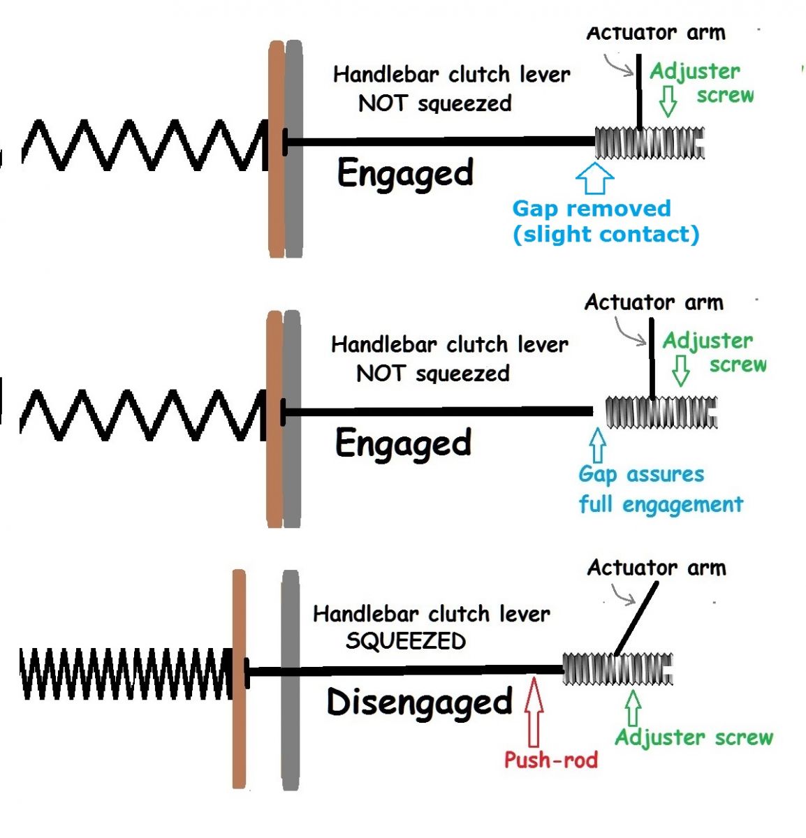

Yes, just until it makes contact, which initially removes the gap, then turn out 1/4 turn which adds the slight gap to assure full engagement whenever the clutch lever isn't being squeezed.

One thing to realize is that as long as there is a small amount of free play at the hand lever, and when you pull the lever you get smooth resistance as the clutch releases, then you got the clutch adjusted correctly.
If the clutch is adjusted like this and you get a loud clunk followed by lurching when putting the bike in gear that means the clutch plates are sticking together. That is a common malady on a bike that sat for many decades without running. Taking the clutch apart and separating the plates will solve that issue.

Patton....I've seen your diagram several times during searches. I'm new to the KZP but not to this concept and feel pretty good about understanding how it's supposed to work.
Nessism.....the "loud clunk....lurching" is what I'm getting. As far as I know this bike hasn't sat around all that long not being used. I just got through taking the clutch pack out and inspecting it.....nothing was stuck together. I've had clutches in my brit bikes that had to be un-stuck every time I rode them. Changing the brand of friction plates would cure that. I want to believe the dragging clutch is a friction plate problem and hope I get good results when I change them out. When I had it apart.....I checked for warrped plates, thickness and clearance at the basket....all if that was well within specs. Adjusted the clutch to where I thought it should be and the action was good.....BUT...the plates were still not releasing and I had to readjust it. I took the rod adjustment screw all the way until it stopped then backed it off 1/4 turn. Tried it again and it was better but I have to believe that wasn't enough slack in the rod so it's sitting waiting on new (oem) plates to get here and we'll try that. IF....that doesn't fix it....I don't know what to do. I don't own a boat so there's no use in owning an anchor.

Re: Today's stupid clutch question KZ1000P
26 Apr 2017 09:45
Gap should be the minimum required to assure full engagement of the clutch plates when the hand lever isn't being squeezed. Which minimum gap maximizes disengagement of the clutch plates when the hand lever is being fully squeezed.
A gap that's larger than necessary wastes available hand-squeezing movement of the clutch cable by using up more of the hand-squeezing movement to first close the gap before the adjusting screw exerts pressure against the push-rod.
A gap that's larger than necessary results in less clutch plate disengagement when the clutch hand lever is fully squeezed.
A gap that's larger than necessary may produce more lurch when putting into gear.
A minimal gap may produce less lurch when putting into gear.
If the plates are "sticking" for whatever reason, the lurch will probably happen when putting into gear, regardless of the gap size, but more likely to fully disengage (un-stick) with a smaller gap, and less likely to fully disengage (un-stick) with a larger gap.

Patton, when you say "gap" I'm assuming you mean the space between the rod and the rod adjuster screw????
I'm curious to to watch the pressure plate this time around. I'm going to do the adjustment (after the new plates are in) with the clutch cover off so I can measure the pressure plate travel. Not that it will tell me much but I am curious.
Just day dreaming here but.....I can't remember if you'd be able to actually see the end of the rod with the pressure plate in place if the disc pack was out of it??
