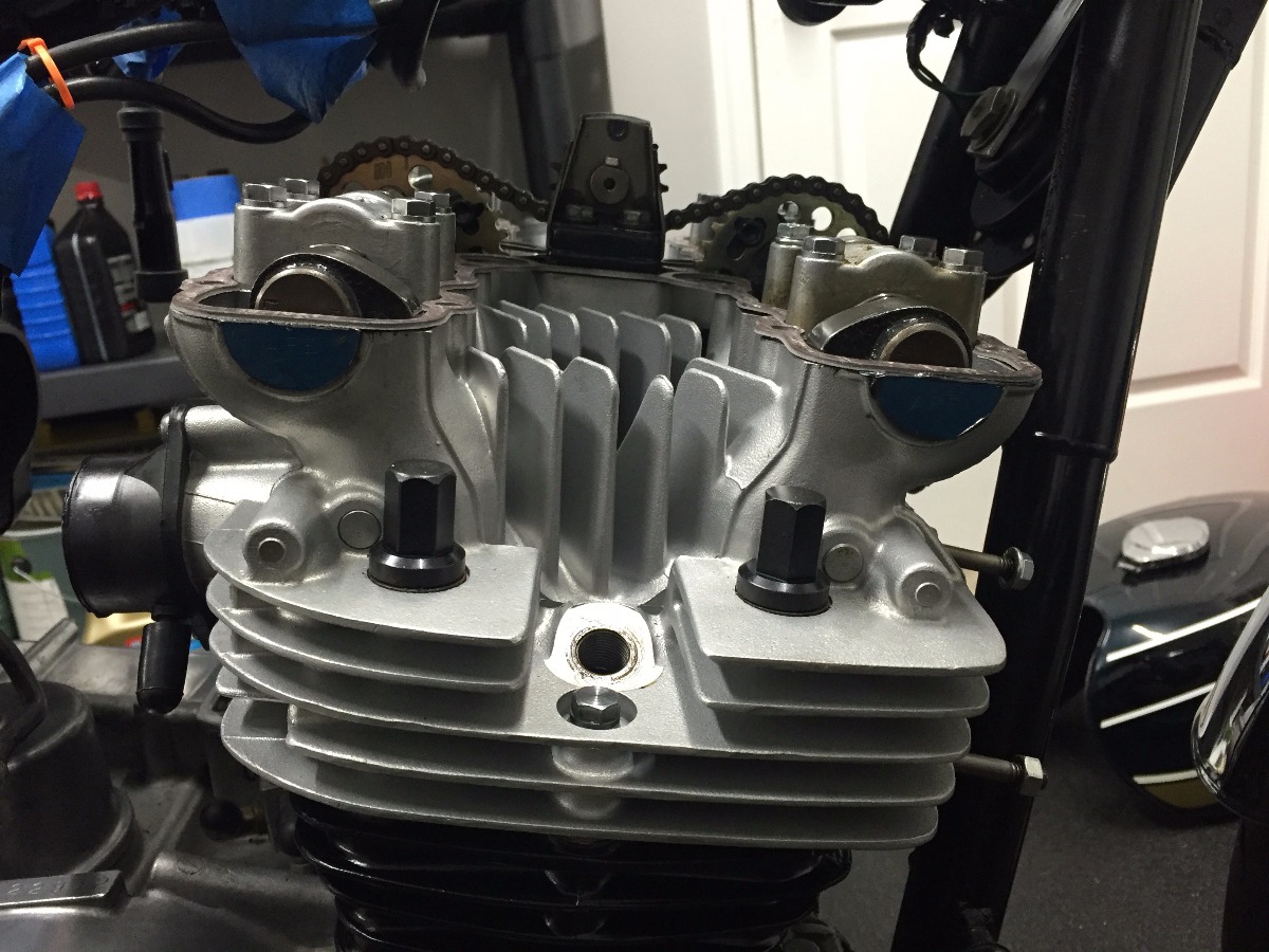

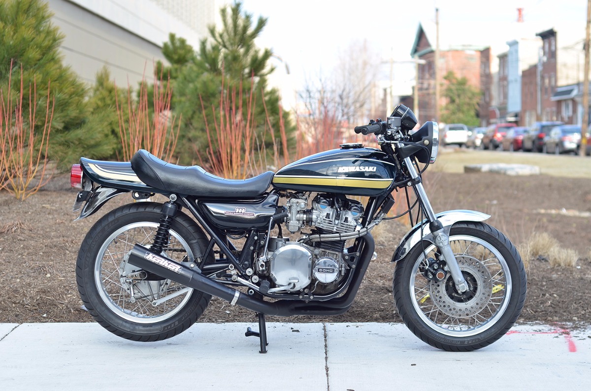

HI guys,
I've posted on here a couple times before.
Quick question about rpm redline and where the bike is making power.
Bike setup:
- weisco 1015
- kenny harmon L1 cams - .400" lift / 256 duration at 50
- Larry C street ported head
- APE valvetrain. springs / valves / guides
- tsubaki camilla cam chain
- keihin crs29 carbs
- kerker
- dyna s
So here is my situation:
The bike runs great. Rips super hard. I love it.
The bike has normal power at lower rpms, and then around 6,500 rpm it really starts pulling, and it pull strong all the way to 11k rpm.
Shit, it'd probably make power past 11k rpm. It just wants to keep pulling.
Don't overly judge me, but I never timed my cams to get the exact lobe degree numbers.
I have adjustable cams gears.
I made the cams perfectly face each other... then I advanced the intake in a hair, and retarded the exhaust a hair.
I'm aware that fine tuning the cam lobe degrees will shift power around in the power band.
105 / 105 will be higher rpm power, where 110 / 110 will be broad across the range.
My main question is... everything feels great and I want to leave it as-is.
If i'm really juicing it... Is revving to 11k rpm okay with the APE valvetrain?
Can the springs handle it with my cam set up
The Larry street port head seems to flow at that rpm pretty well.
I guess I'm looking for some input if i'm playing with fire revving to 11k.
What have you guys experienced?
I guess I could go and actually have the bike dyno'd... to see where power falls off.
But that still won't tell me when valve float is or could occur.
Any thoughts / feedback welcome.
Thank you.

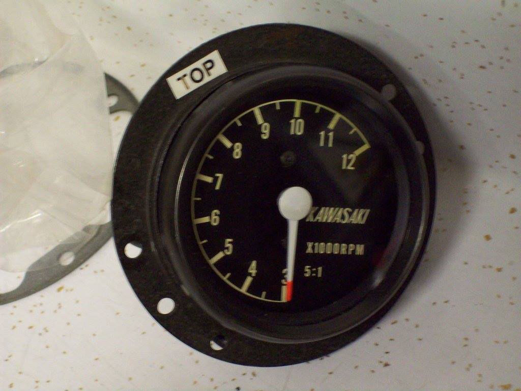

23 Apr 2017 10:44
Stock tachs are very inaccurate, and highly optimistic!!!! When I ran a stock tach on my Superbike, I shifted at a indicated 11,000RPM. When I got my hands on a highly accurate Kawasaki road race tach, that very same motor and gearing would not pull over 9,500RPM on that tach. Big difference don't you think. So 11,000RPM on a stock tach is most likely pretty close to an actual engine RPM of 9,000 to 9,500RPM. Watch Ebay a few of these Kawasaki road race tachs show every once and awhile.

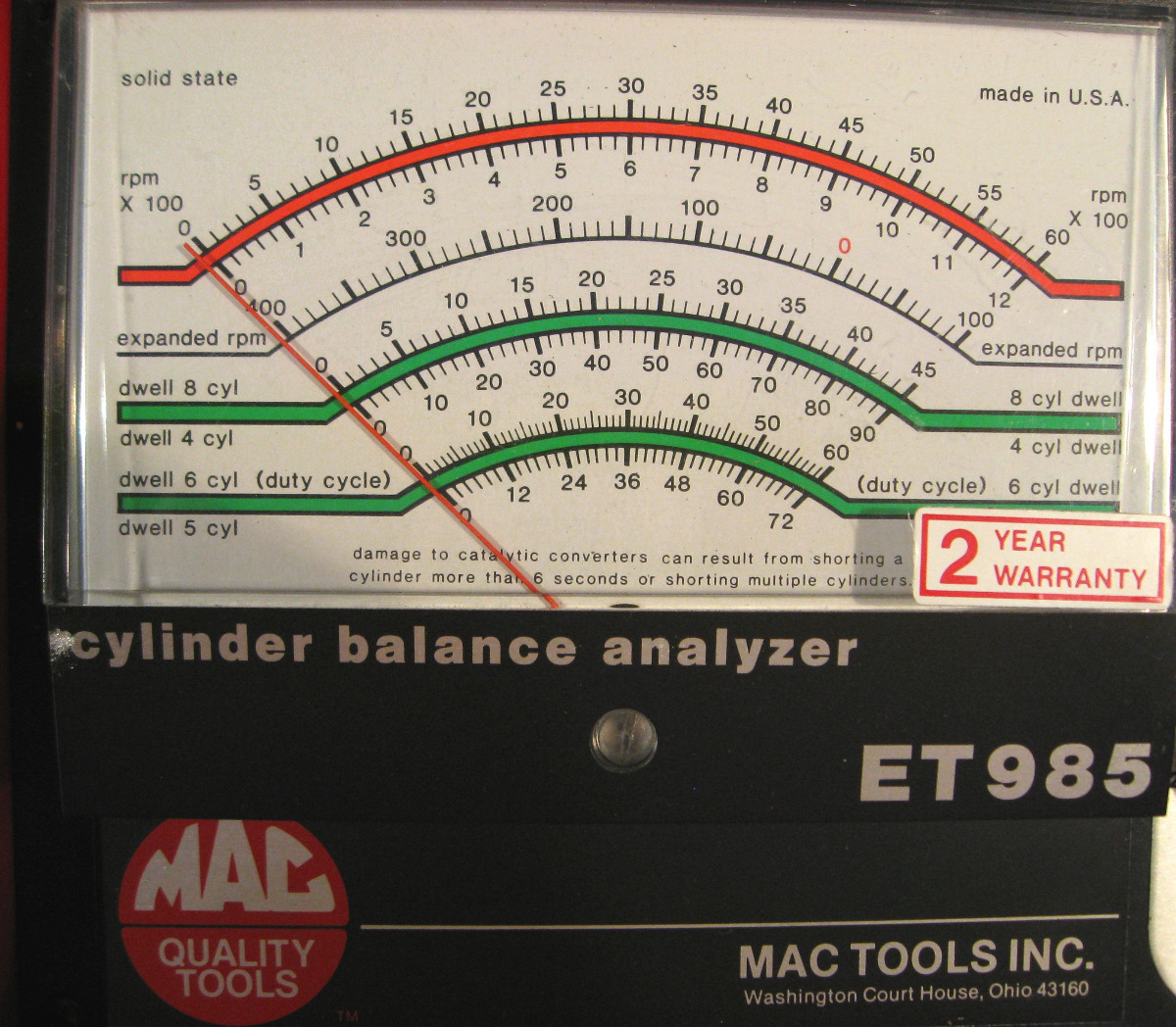

23 Apr 2017 11:32Dr. Gamma wrote: Stock tachs are very inaccurate, and highly optimistic!!!!....
I'm sure some are inaccurate, but some stock tachs actually are pretty accurate. If one has a Cylinder Balance Analyzer or some other quality dwell meter device that measures rpm the accuracy of the tach is easy to check. I found the tach on my KZ650-C1 was very accurate when I checked it using the MAC tool shown below. Ed
