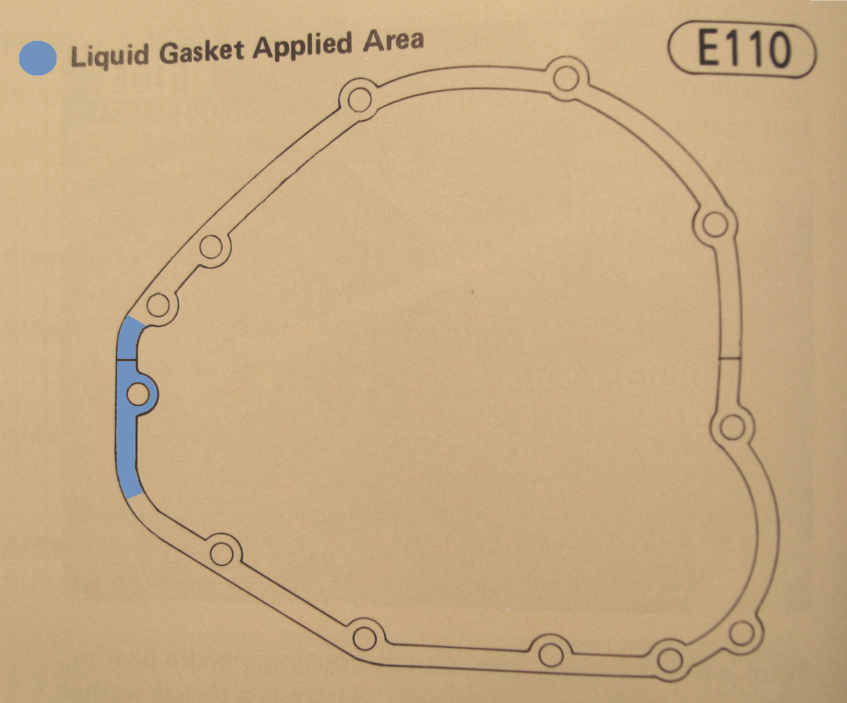

Dry, but take a look in the Kawasaki Service Manual for your specific model.
On the KZ650 there is a small portion of the clutch cover gasket that gets sealant. It is on the engine side of the gasket where the gasket covers a seam in the engine cases. The image below from the manual shows the area, but your bike's engine is different than that of the KZ650 so it would be prudent to consult the manual. Ed

22 Apr 2017 07:26650ed wrote: Dry, but take a look in the Kawasaki Service Manual for your specific model.
My original gasket had sealer here of course and I put Yamaha 4 on it when I recently replaced the clutch, springs and oem gasket..... had the cover off 3 times at least over the years and never had a leak.
What I find weird is the manuals don't say anything about a little sealer on the other side where the case meets too.... I left it dry like they did from the factory and have had no problems there.

22 Apr 2017 07:31KZB2 650 wrote: ......................What I find weird is the manuals don't say anything about a little sealer on the other side where the case meets too.... I left it dry like they did from the factory and have had no problems there.
I also found that to be strange, but like you I left it dry and have never had a leak. Ed
