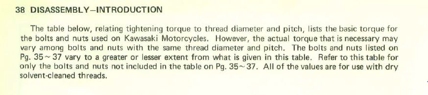

Everyone is free to do what they want with their engine, if all parts both engine block and bolts are thoroughly cleaned, the prerequisites are good when tightening with torque. I myself started repairing motorcycles and mopeds at the age of 11-12 with a mechanic father who supervised from the time they hand-scraped bearing surfaces for proper fitting. Tension bolts must be constantly replaced but other bolts can be checked visually in my world. I am now 61 years old, have professionally repaired cars all my life and motorcycle as a hobby. It has never been wrong to use oil on parts and contact surfaces during assembly, that was the first thing I learned and still do also on bolts

18 Apr 2022 07:06 - 18 Apr 2022 07:35But be careful about putting oil on the threads of bolts. The torque specs in the Kawasaki Service Manual are for dry threads, not oiled threads. EdIt has never been wrong to use oil on parts and contact surfaces during assembly, that was the first thing I learned and still do also on bolts
