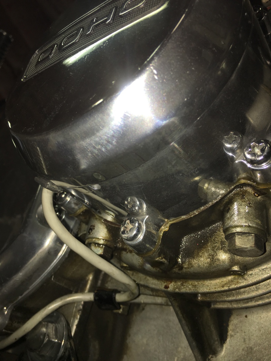

12 Mar 2017 15:44You mean the small case behind the ignition advance mechanism? A rather easy fix with a new seal if yes.Skiprrdog wrote: I just finished replacing the rubber plug in stator cover, fixed that leak, but now I notice a new one. 1976 KZ900A4, starts, idles, sounds okay, but I have drips coming off of the bottom of the inner (next to engine cases) timing cover. I took the outer cover off, no oil there but have not taken off the inner cover yet.

Here is a picture, yes, the cover that mounts to the case with six bolts. Not much to see, but you can see the oil about ready to drip off of the bottom-center boss...

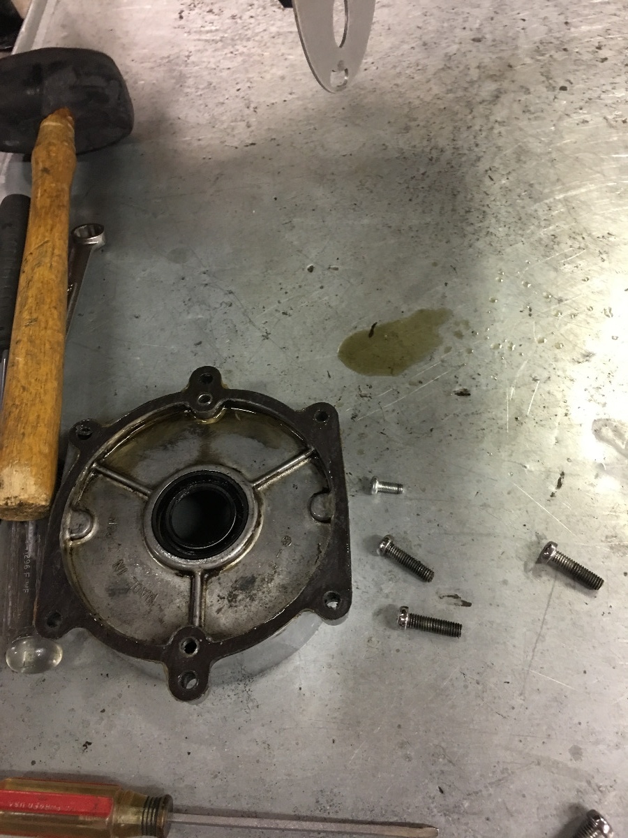

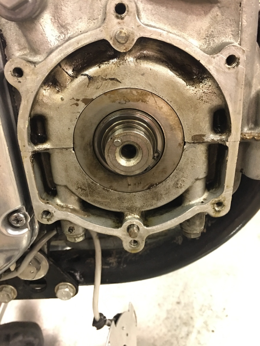

Here are a couple more pictures. Took the covers off, and as you can see, there was a small amount of oil behind the cover. That gasket is obviously leaking, but I am not sure how much, if any oil is supposed to be behind that cover!

No eBay APP ID and/or Cert ID defined in Kunena configurationSmear a light coat of silicon on the gasket and threads of the bolt. Yes, there is oil in there.I get my gaskets here.

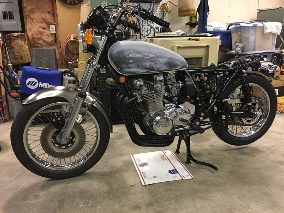

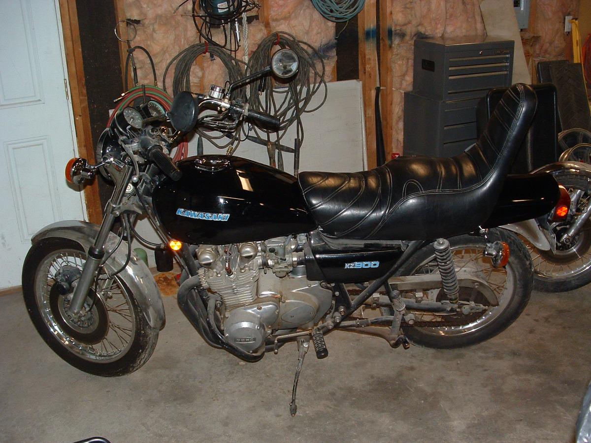

Here is a before and almost done picture of the bike. Dont know if I want to put the chopper seat back on it yet

Depends on how long of rides and if you carry a passenger or not. Nice bike.

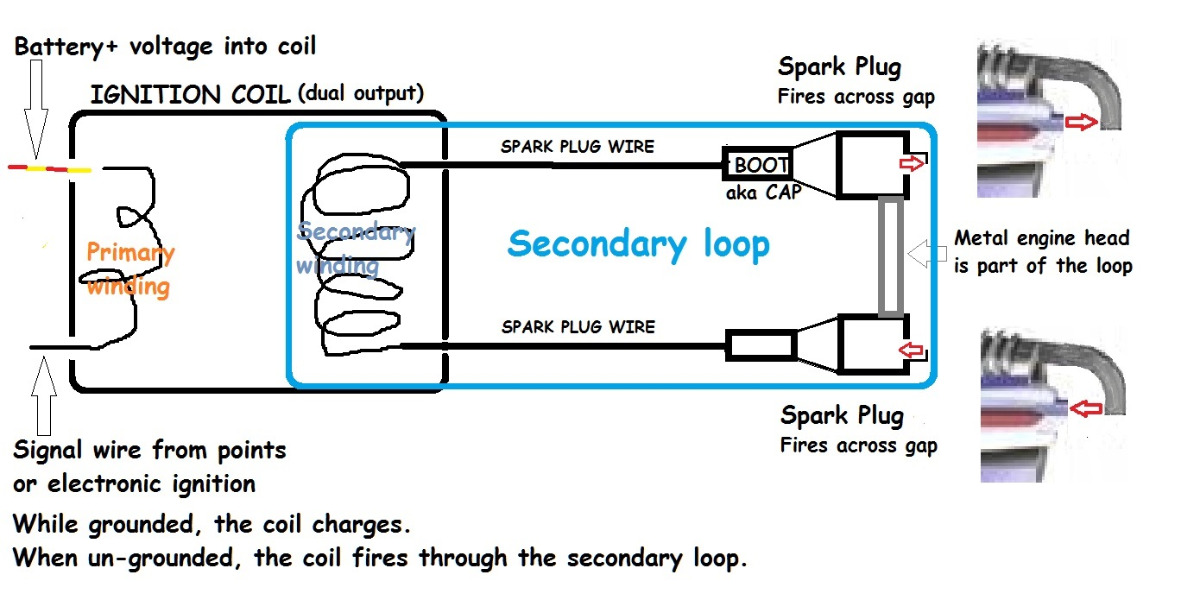

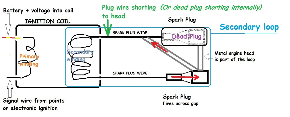

If the spark plug wires are old, hard, cracked or otherwise deteriorated from age or whatever, there could be high tension voltage leaking and causing erratic loss or weakening of spark.
I believe this was an issue with models equipped with coils having integrated built-in plug wires, where the aging wires deteriorated even though the coils themselves seemed perfectly serviceable.
The fix for me was new Dyna green coils plus new Dyna plug wires (caps come already fitted with the the new wires). The Dyna plug wires are readily available and relatively inexpensive, and come in black, red or yellow color.
A shorted or otherwise defective spark plug can also cause the engine miss, where combustion will fail on 1 or 2 cylinders leaving the engine "running" on either 3 or 2 cylinders.
With the large fours, you can limp home on just two cylinders.
