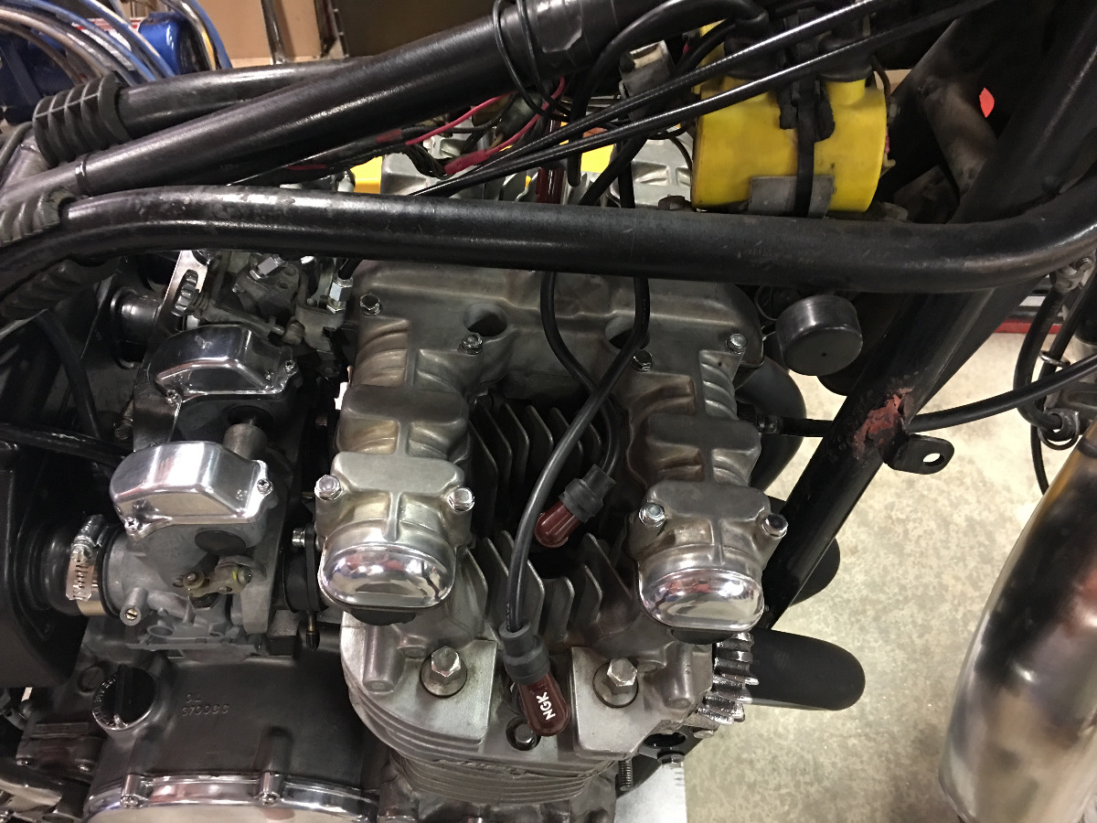

--Patton...thanks for the diagrams. I have to get a new battery for my meter, so tomorrow I am going to spec everything out. Plugs are new(er), but first just for the heck of it I will swap plugs on two sides and see if it makes a difference. The bike also has a new (PO) Dyna S module in it. The left coil I have connected to 1 and four, and the right coil to two and three.

15 Mar 2017 19:36Skiprrdog wrote: --Steve... Thank you!
Those would be resistor caps on the end of your plug wires, and likely copper-core wires. Wouldn't hurt to check each one for tightness...they are just screwed on the wire ends.
What make and number are printed on the spark plugs?
