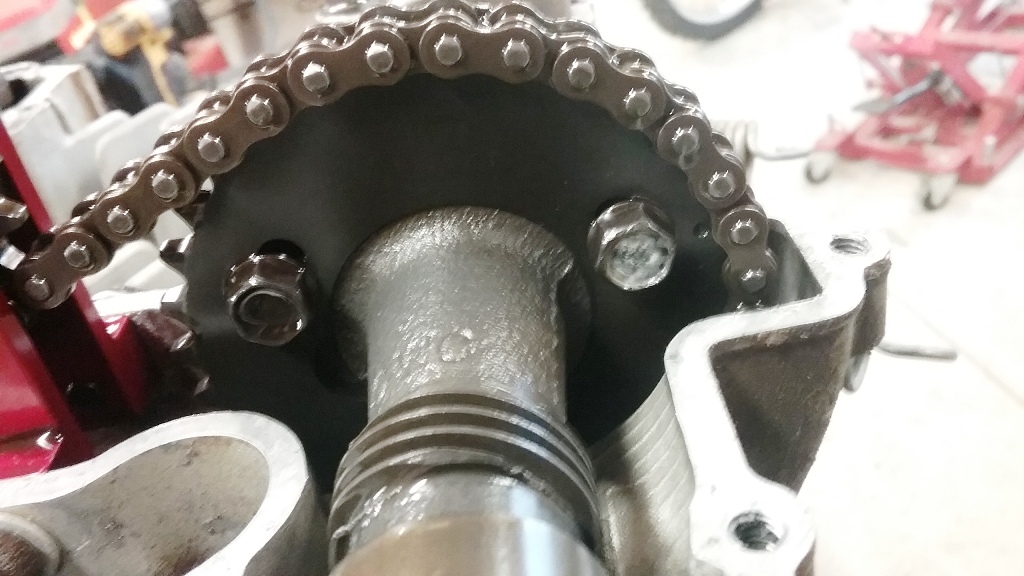

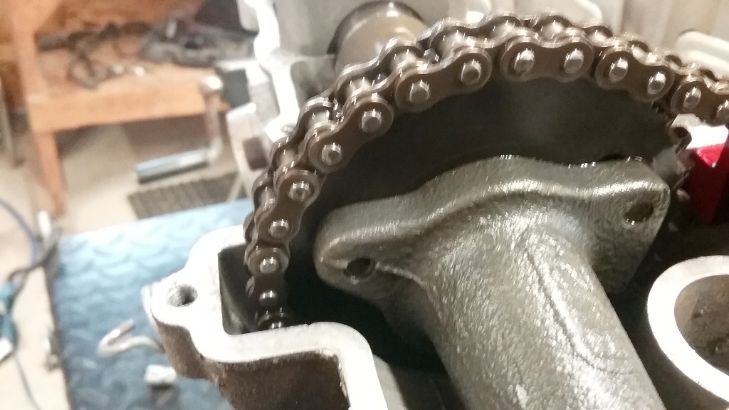

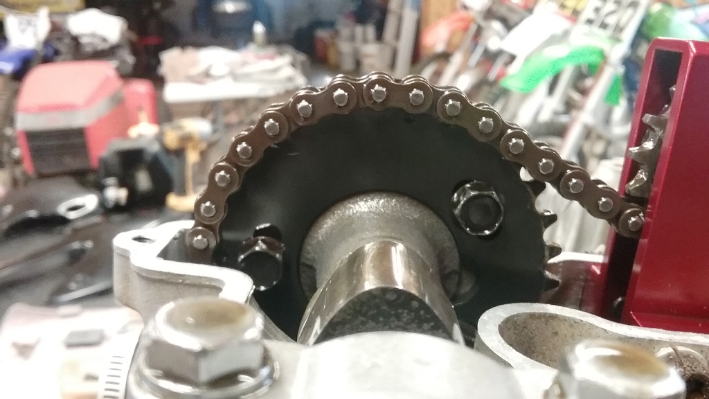

28 Feb 2017 14:10OK, first pic is the exhaust cam sprocket, showing the dot...then the other side - I thought maybe there was a cast-in arrow there on first glance, but actually I don't think that's what that is...although it's close.
Then a pic of the intake cam sprocket, showing it's dot.
Don't actually know what brand those cams are - maybe someone will recognize them. But the motor was running fantastically before we cracked the cases

Those look like slotted sprockets. I'd check the degreeing.

Why make things more complicated and add extra work for no reason.
If it ran great before the strip and you haven't had the sprockets off or moved them then there's no need to check anything.
Just stick it back together as per normal and it will run as before.
The dot on the exhaust cam sprocket is the timing mark ( Instead of the arrow) and should be somewhere close to level with the head surface. A little either way is normal depending on camchain wear, deck height etc but never enough to be a full tooth off.
To id the cams there should be either stamped numbers near the sprocket flanges or on the end of the cam or engraved numbers/letters on a machined flat in the sprocket area.
Any cast letters like CWC or K259 mean nothing and are just casting blank codes.
