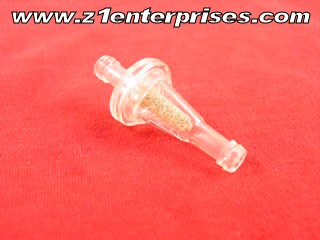

thanks, i will look into that this weekend. it does have the see-through inline filters, is there a filter type you recommend?

I don't know what size line you have, but I use a couple different types on my 550 which uses 5/16 line (originally 7mm?). I tried a couple to see what works better or if there are any problems.
I use these:
www.z1enterprises.com/product/KL19-1271-1
These are a simple metal screen.
The ones I have worked really well for years and I haven't had any problems even with running ethanol.
But some have said there are versions of this out there that get softened over time.

This is the type I've seen get soft, turn yellow, and eventually break with ethanol use.

thanks, I just ordered a pair of the one at the top from z1. Hopefully, that will help and hopefully i can check into all these things, and report back this weekend, thanks for the help
