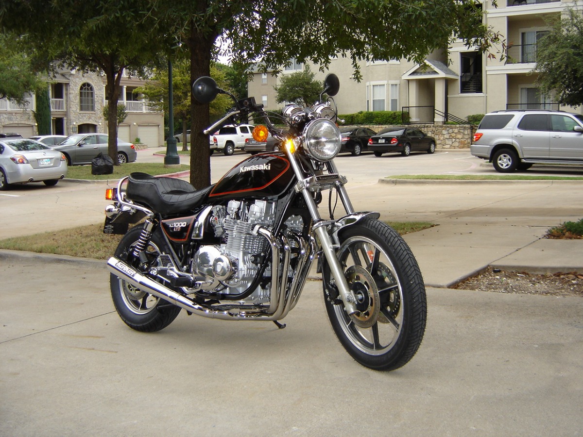

23 Mar 2017 18:26 - 23 Mar 2017 18:38Kray-Z wrote: The MAC and I believe the V&H allow easy oil changes.....the Kerker you might have to drop the complete exhaust to get to the filter, and if you don't want to drain the oil on to the pipes....
Actually the newer Kerkers made by SuperTrapp aren't the same as the originals. They re-routed the pipes for easy oil/filter access, and no more springs at the head. Don't know if that hurt performance, but definitely more convenient, and they still look awesome!
Here's a good shot when mine were brand new. Chrome is discontinued. Found NOS on a shelf in Germany.
