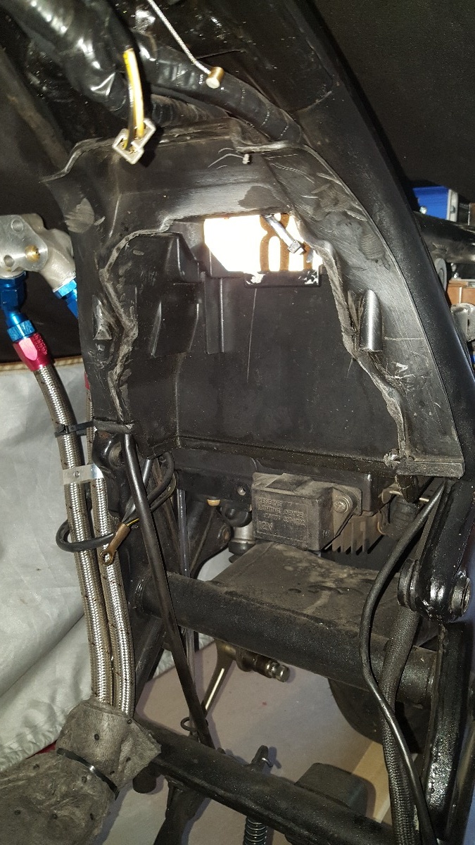

Nothing fancy. Just took off everything with a cutting wheel except the back and top (intake). regret removing the bottom section that covered the regulator.

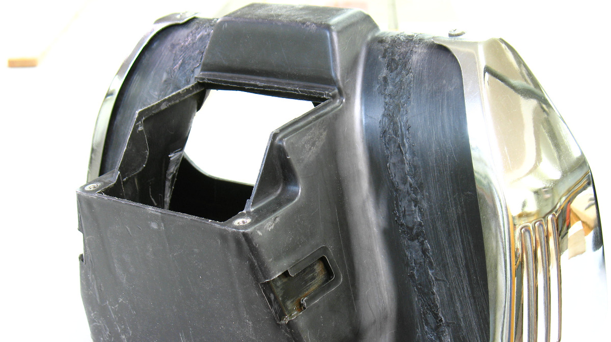

Whoa dude!
:ohmy:
Same air box!

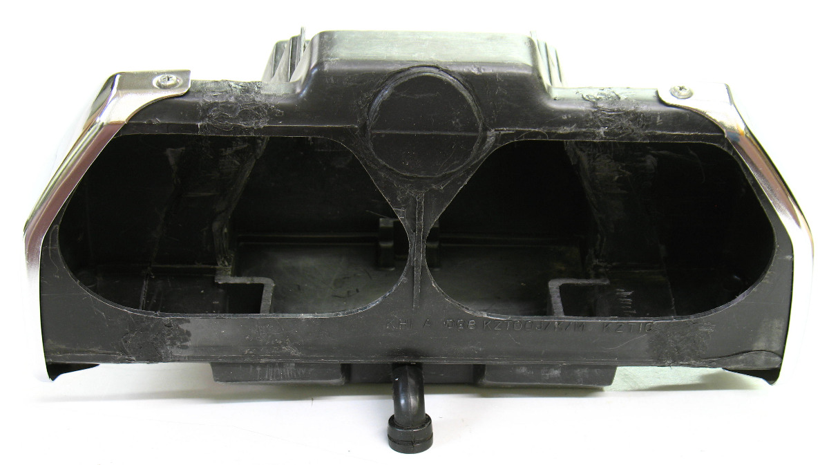

Modified to enable use with Mikuni KRS velocity stacks, because the air box is approximately 1.625" too narrow in its original form. The configuration was set up to also accommodate Ramair foam filters which fit the stacks.
Same air box!
