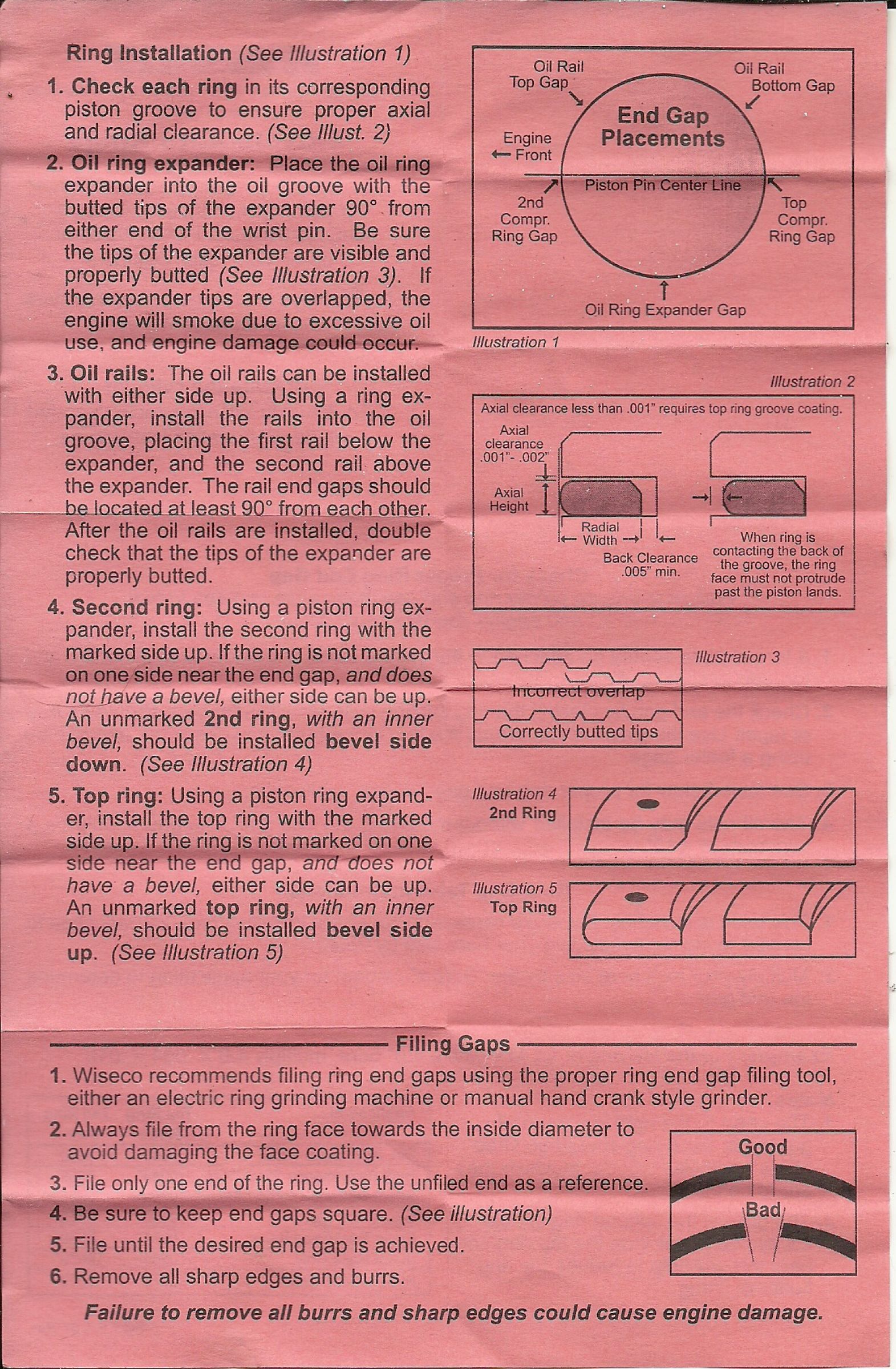

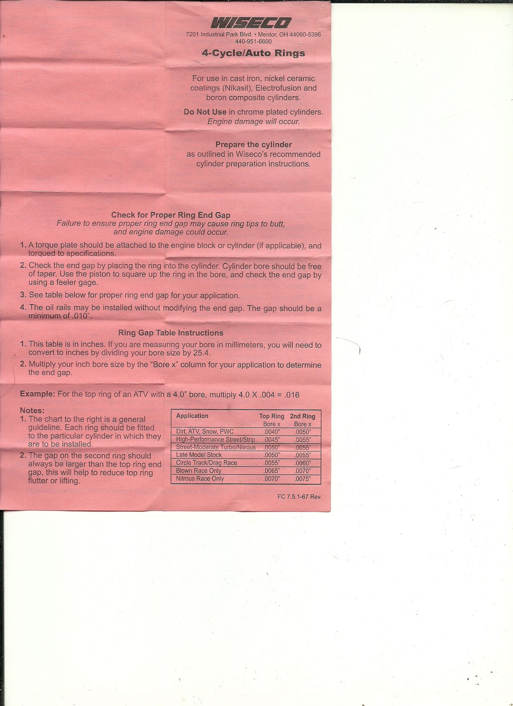

What was my best local parts guy (until he got tired of all the BS he was putting up with here and moved away, damn it...) stopped recommending Wiseco pistons (aren't all of Wiseco's performance pistons forged - BTW?) completely.
I asked him about that, as I have never had any quality issue with any Wiseco piston; in fact I'm an ardent promoter of the drag racing KZ1260 super-lights (out of production now). He said too many customers were complaining of seized pistons when they were installed by his mechanics. I asked what cylinder clearances they were using. He said "whatever is on the box label". I said "that is why you are having problems"....

- 750 R1
- Posts: 1150
- Thanks: 390
