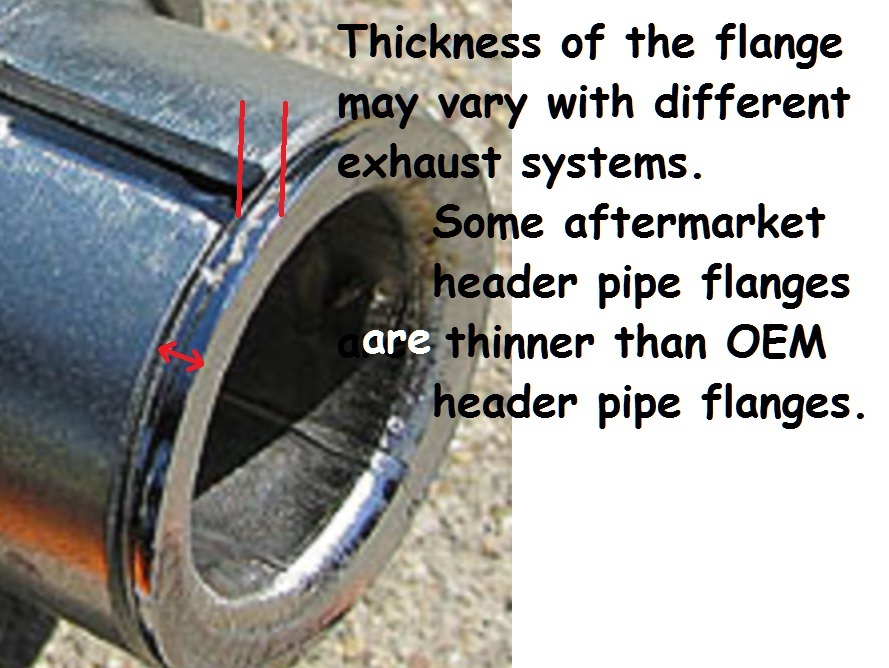

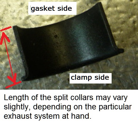

Make sure gaskets are not already stuck inside the head. Use new gaskets and make sure you have stocksplit collars rather than collars from an after market pipe. Some aftermarket pipes use collars that are a different length than the stock ones so they don't work properly with stock pipes. Ed

The diagram sais it all. Thanks guys!

The used exhaust that I purchased had collars with it. I will use those. Thanks for the advice.
