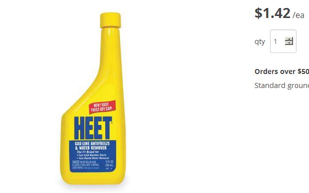

We ride a lot, but when it looks like it is going be a long cold snap going into Winter I add some of this and ride for a while
78 KZ1000 A2A
