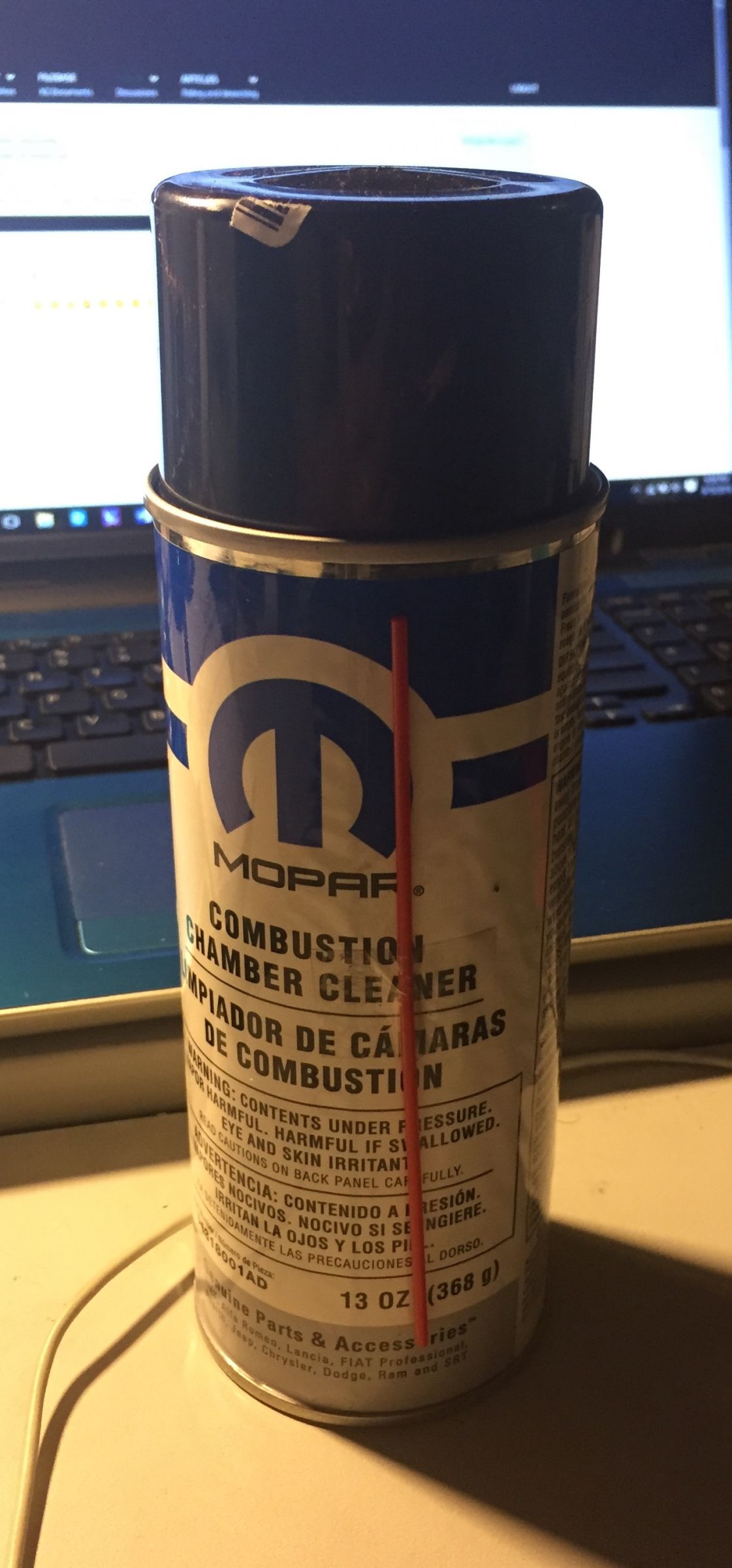

missionkz wrote:
TexasKZ wrote: Mopar markets a combustion chamber cleaner that is supposedly da bomb. I've not tried it, but guys on a couple of other forums claim they have had good results with it. It is available at CDJ dealers.
This is the stuff I used last time I decarbonized.....
