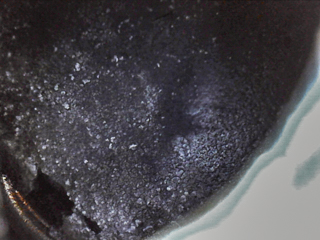

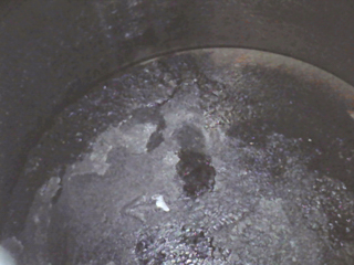

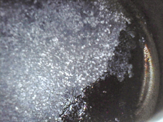

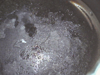

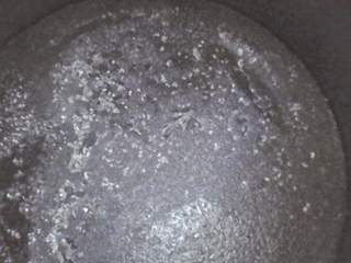

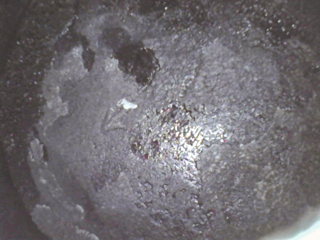

Thought it'd be nice to post what I found on top of the pistons with the endoscope.
Lets start off with the problem child....cylinder 2
Next, cylinder 1 looked like it was leaking some serious oil or something. The black stuff on the side the bike leans when parked.
Cylinder 3 was remarkably clean other than one tiny blotch of black.
And cylinder 4...also remarkably clean short of a small blotch.

Valve guide seals. Not bad for a 30 year old bike. ;)
