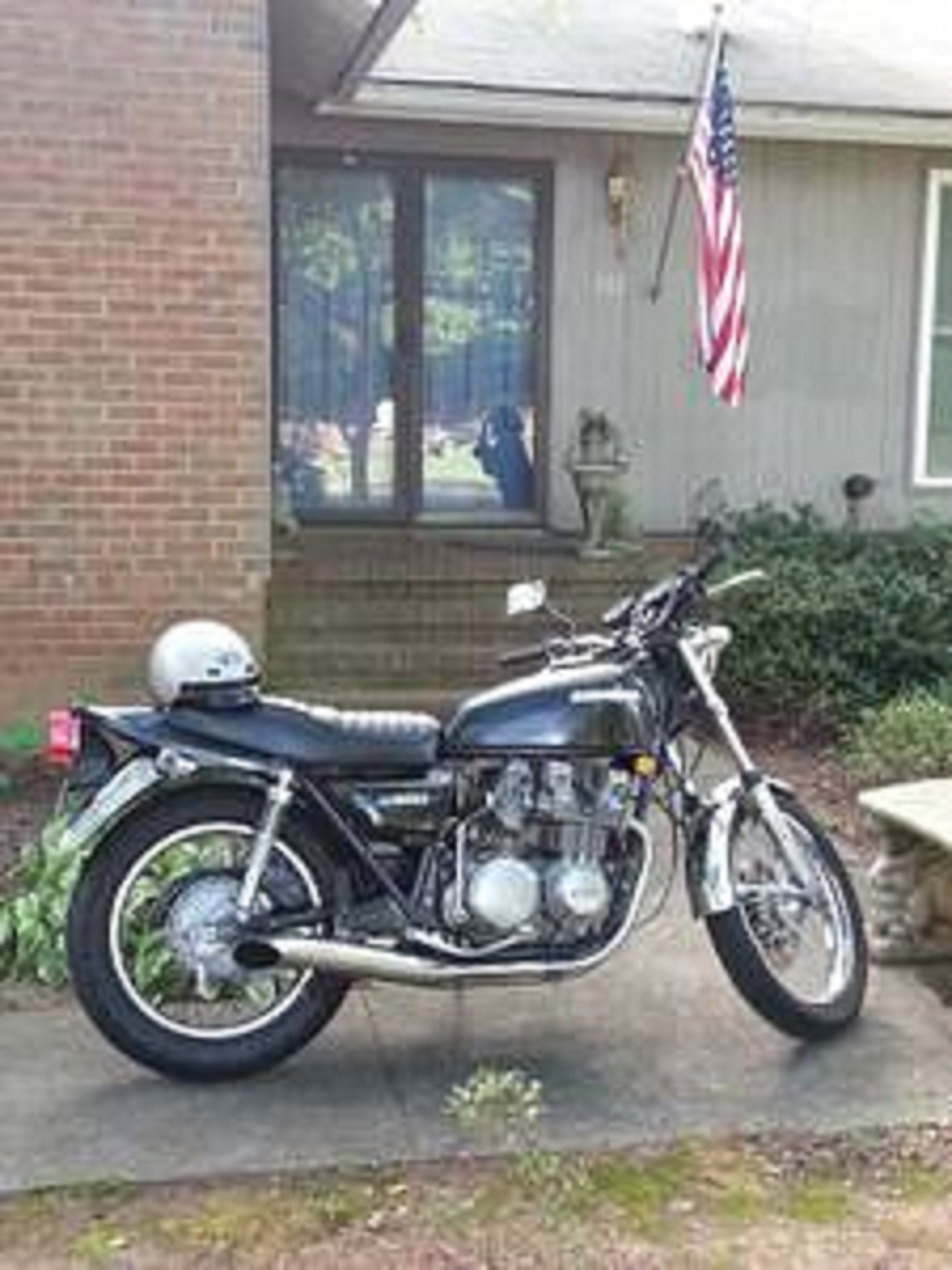

BIKEMECHANIC73 wrote: . . . I keep getting this message when I try to post a pic of my Bike "Attachment image size exceed limit allowed by configuration"
Attachment 1978KawasakiKZ650.jpg not found
Pic in above quote is JPEG 225px x 300px.
Here it is in JPEG 450px x 600px.
Here it is in JPEG 900px x 1200px.
2400px is the maximum width size for an embedded image.
1200px is the maximum vertical size for an embedded image.
Sizes that exceed 2400px width by 1200px vertical, or slightly exceed either of those dimensions, may be automatically resized in a forum post, but attempts to embed grossly oversized pics will usually produce an error message.
