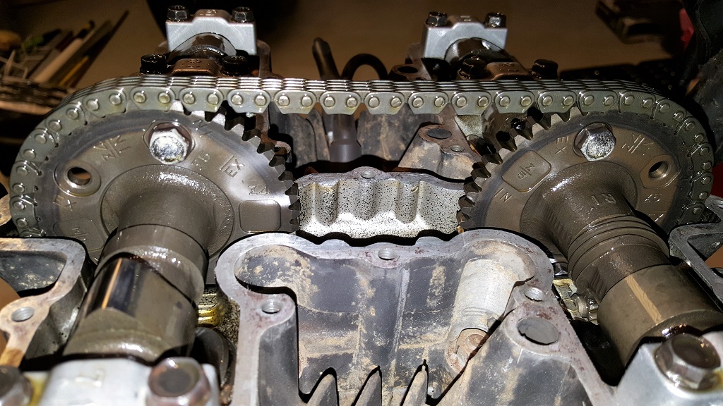

I fell into this problem with my '82 550a not too long ago. Couldn't seem to get the two gears aligned as per the manuals.
Problem one - I was using the Clymer manual which is somewhat vague and/or plainly wrong
Problem two - I wasn't depressing the cam chain between the gears once set, so the rear intake cam gear was always rotated backward beyond what the manual stipulates - and here in lay the rub - the cam chain will be deflected downward between the gears ONCE the valve cover is bolted down (hence why you must remove your auto-tensioner to allow slack in the chain.
I ended up doing this process 4 times, my first time ever adjusting my 550a valves due to using the Clymer manual. Hope you have better luck!
Notice how the cam chain is straight across?
The valve cover has a plastic/nylon guide which causes the chain to deflect downward between the two gears and until you press your thumb down upon the chain with the auto-tensioner removed, your rear cam gear won't appear as the manual stipulates.

If you have the cross wedge type tensioner there is no need to remove it. Just remove the spring cap and spring, and pull back on the wedge slightly to make sure it's not jammed in tight. The tensioner plunger spring will push on the chain, but when you pull the chain tight to install the intake cam the plunger will move back to the proper position. After you get everything aligned properly and install the valve cover back on, the last thing you do is install the tensioner spring cap back on.
A few suggestions which may help you...
- remove the round ignition plate and let it dangle on it's wires. It's much easier to see the 1-4 T mark this way.
- Align 1-4 T, pull up on cam chain in front and install the exhaust cam. Aim the EX mark slightly down because when you tighten the cam caps the mark will align with the gasket surface.
- After you snug up on the exhaust cam caps double check the 1-4 T and make sure the EX mark is properly aligned. Only then can you move to do the intake cam.
- install the intake cam, counting the link pins on the chain per the manual. Snug down on the cam cap screws.
- install the tensioner cross wedge spring and lighten tighten the cap. This will allow you to turn over the engine without fear of the chain jumping any teeth. Spin the engine over with a wrench a couple of turns and then double check the cam timing. Assuming all is well, remove the tensioner spring cap and spring once more and install the cam cover. Last step is installing the tensioner spring and tighten down the cap firmly.

The rolling off the mark is not from compression unless you are spinning the motor full rotations. That should not be necessary. Don't worry about the plugs.
As Ed Nessism said, you only need to remove the cap/spring and make sure the crosswedge is moved outward a bit.
Kayodash wrote:
I tighten the camshaft caps with the chain off (laying on the cams). I only start timing the cams after they are full installed.
Kayodash wrote:
If the BOTTOM of "EX" is lined up, then you are off by a tooth. You will need to walk the chain over the sprocket....(bottom of the wording EX level with surface)...

I'm sure there are many ways to do it, but the way I found works best for me is:
1) confirm the crank is at 1-4 TDC.
2) lay the cams in place (with sprockets) so the end notches point outward.
3) very methodically tighten the caps so the camshaft goes down evenly. don't tighten any more than others because the camshaft will want to rock into position. If the low end isn't allowed to rise, the camshaft will bind.
4) remove the sprocket screws and let the sprocket slide off the flange onto the shaft portion.
5) now it's really easy to time the sprockets and slide them up onto the flanges to check the position. (Crank will not move.)
6) when the sprockets are timed, I rotate the cams slightly so the sprocket screws can be installed.
7) torque the sprocket screws ( it says to use threadlocker, but I don't and have gotten away with it. It makes a mess when removing the screws. Use a towel to catch the bits of old thread locker. I then clean them up on a wire wheel.
You can shortcut this by not removing the sprockets, but then it is a lot more juggling when installing the cams and getting the timing to work out correctly. I just learned my method and stuck with it. Since my way does not affect the crank until after the sprocket are timed, there is no issue with the crank rolling off TDC.
But the sprocket screws are not easy to remove after the chain is off and cams are loose. They are threadlocked. I do this before removing the cams, so I can use the motor to stop the sprockets from turning. You can try to use a screwdriver as a bar against the 10mm socket to stop the cam from rotating.
Sometimes the chain can get balled up at the bottom of the motor. If you think this has happened, rock the crankshaft back and forth a little while pulling up on the chain. Then make sure to put the crank back to TDC.
Remember, there is always spring tension acting on the chain because of the tensioner. But this should be easy to overcome by pulling on the chain. The tensioner is free to retract, so it should give back the slack.
When you tighten the cams initially, you should be using a nut-driver type tool... nothing with any leverage. If you can't install it with a nutdriver, something is bound up. Start over.
Before doing any of this, make sure all of the oil is out of the cap screw holes. Excess oil will contribute to stripping the threads due to hydrostatic locking. Same goes for the valve cover screws. Make sure there is absolutely no sealer in them either.
Sealer and oil don't compress, but they make the screw feel easy to turn. That leads to cleanly stripped threads.
You can go slightly lower on the torque than the manual specifies and be safe,
