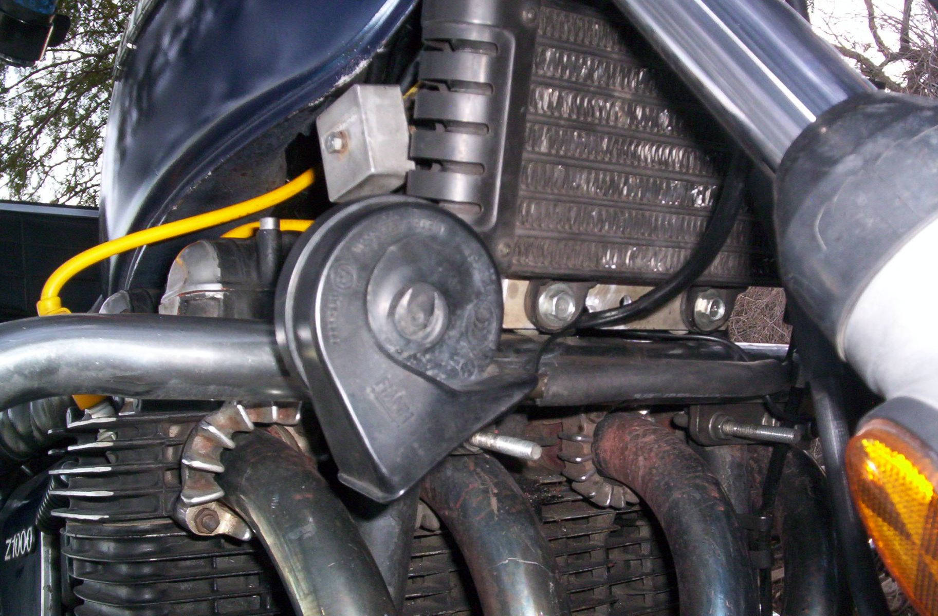

I'm running this:
www.jegs.com/i/B%26M/130/70265/10002/-1?..._49KK-SNgaAkP_8P8HAQ
mounted here:
I have not hit the summer heat in AZ heat so I may need to add a fan or two with a thermostat.
mounted here:

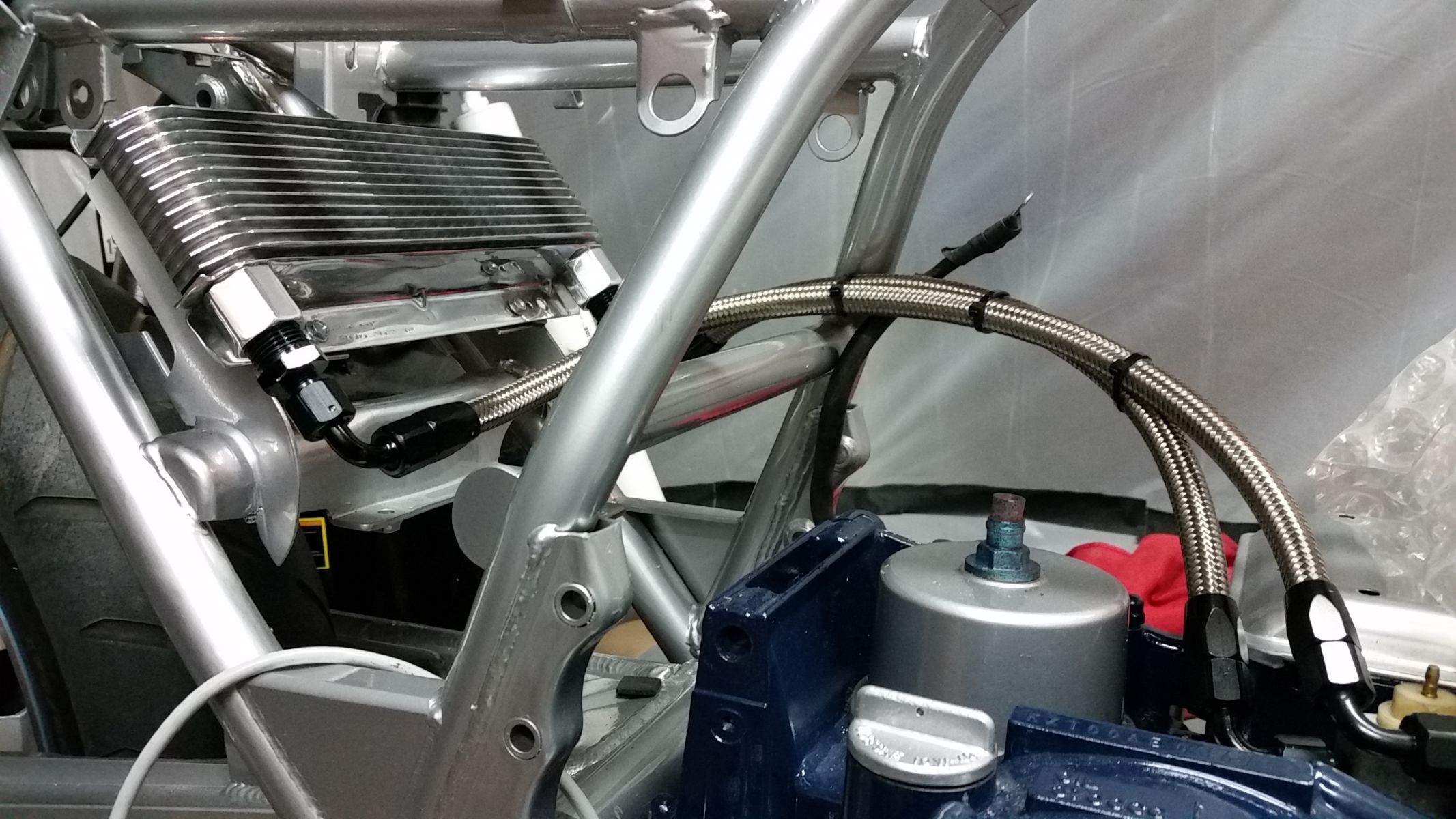

If it's stock the Lockhart should be good enough. I bought one from one of our members. ZX7 I think. Had to open up the ports from 3/8 to 1/2" to be certain I have enough oil flow.

You'll need the fittings to replace the oil rizer like I have in my thread. My cooler takes about 1/2 quart. I put the intakes upside down so the oil in the cooler wouldn't flow back into the engine. The one I had before, the oil light stayed on for a few seconds until the pressure built up. Now it's immediate. They changed the rizers on the later engines. Got a pic of what you have?

Correction. I ran the lines above the cooler along the back bones, then down in between # 1&2 and #3/4 carbs.
