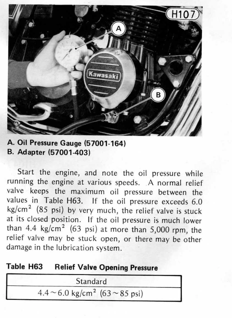

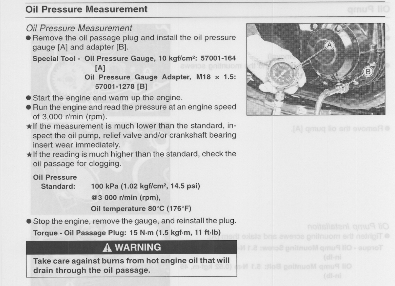

I have also read of the benefits of having additional flow from the zr-7 oil pump, so I have acquired one for my kz750e rebuild.
But one thing still confuses me and that is in the FSM for the zr-7 it shows ( in two different areas) that the oil pressure should be 14.5psi @ 3000rpm. Which is vastly lower than the kz750e FSM listed 28-36psi @ 4000rpm. I know there is a 1000rpm difference but I can't belive the oil pressure doubles in 1000rpm. (Plus I have also checked my oil pressure on my zr550 in the past and it also shares the same oil pump as all the other kz650/750's and it showed 20-25psi @ 1500rpm's)
Does the zr-7 have HUGE oil galleys that provide a large flow of oil but at a lower pressure than that of the other KZ's?? If so, I am worried about over pressurizing the oil system and creating leaks or causing bearing damage from to much flow past the bearing surface.
I am also aware that the zr-7 uses a different design of oil pressure relief valve, but the FSM does not specify what pressure it releases at. The KZ750e relief valve releases at 63-85psi. So could the zr-7 relief valve is designed to blow off at much lower pressure??
